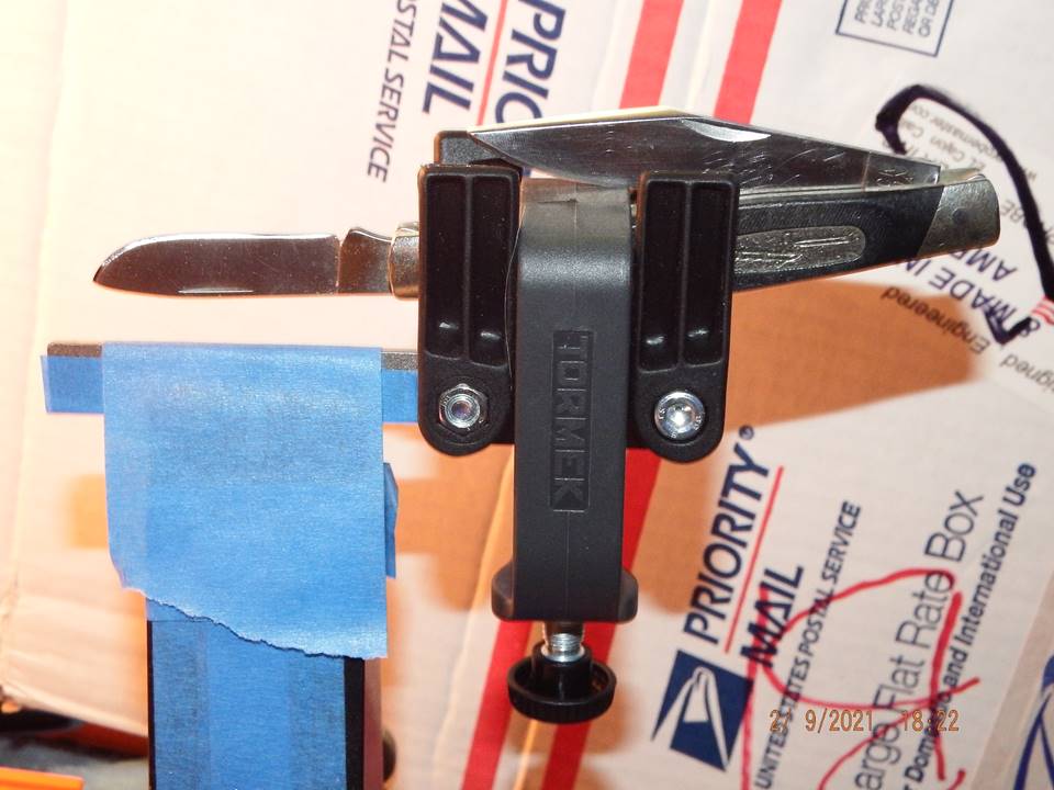

Your Case knife is one of those situations where using a Tormek Small Knife Holder may be needed. This holds the knife offset by the handle.

I bought a Tormek SVM-00 small knife holder to sharpen small blades. It’s a lot quicker and easier.
The Stabil-Rizer also can be used to mount short small knives effectively on the WE.
