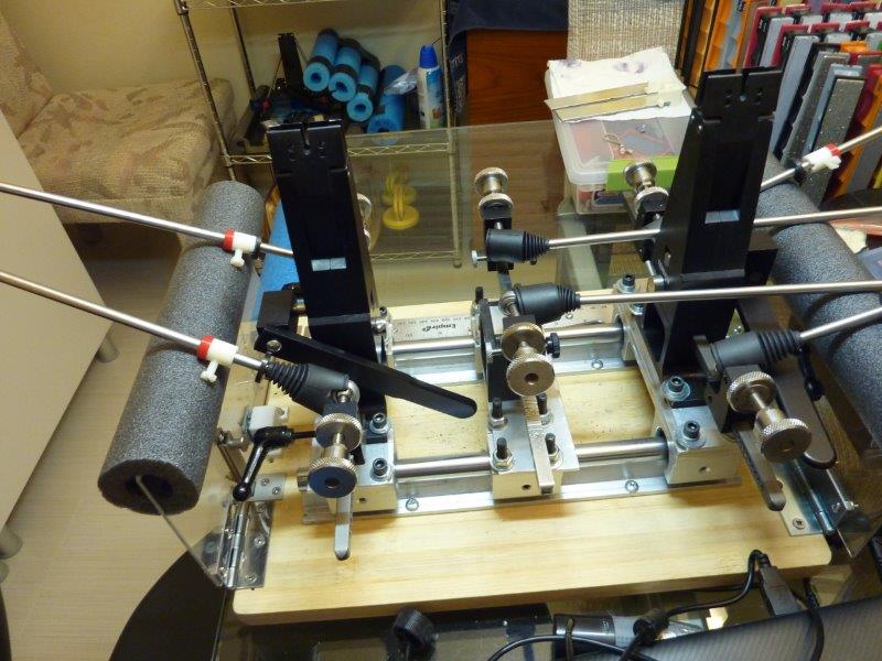

Here’s a concept project I’ve been working with for the last year or so. It started out as a "why not?’ idea and I developed it and refined it into this well functioning and practical working model. It was originally contrived as a method to answer some of my sharpening limitations of my WEPS models. I mostly sharpen kitchen/chef’s knives. Some are large and long. These proved tedious to sharpen with my standard W.E. models.
Many other WEPS users devised methods and adapters to help overcome these clamping limitations. Some used RAM Mount Adapters. Some use framing systems. Others even utilized more then one vise. I wanted the ease of using the Gen 3 vise system and the stability of multiple clamps. I conceived of a parallel linear track maintaining the alignment for two vises so I could use them in tandem on my large and long knives. I shared my ideas and concepts with sharpening peers and confidants and was given this base rail suggestion.
Here is what came of this:
I had this idea that I could use the guide rods from two vises in an overlapping fashion similar to automobile windshield wipers. The idea has proven to work better than hoped for. The sharpening scratch patterns are easily overlapped and blended.
Each vise is a complete WE130 Portable bought new from W.E. and adapted to mount on rolling ball bearing blocks that glide along parallel linear rails. The two WE130 Protables are 100% functioning as designed by W.E. and work independently but identical to one another. The rolling blocks have positioning set-screws to lock them where I need them. The two vises are aligned relative to one another, then secured on their independent carriages. The vises I then roll into position to best accommodate the knife I’m sharpening. The two vise guide rods are set with a zeroed position angle cube for them both.
Instead of needing to sharpen long or large knives in portions while supporting the opposite side. Then move and re-clamp the knives to overlap and blend the sharpening scratch patterns, I now do this in dual vises. I utilize an XL AAG to log their clamped position for repeated sharpenings. I also have a metal ruler on the set-up’s base to record and log the vise’s positions for re-clamping.
I have found that the secure clamping afforded by the dual vises improves sharpening outcomes by eliminating knife flexing. For knives that I had originally sharpened in the single vise set-up I now find I can more securely hold it in two vises. I then have a choice to use the guide rod pair that better matches the knives sweet spot. I have found this limits or almost eliminates the slight edge re-profiling often seen when knives are sharpened with the Wicked Edge for the first time.
The rolling rails and the modular design allow me to use one vise alone. Just like any other WE130 set-up. I can roll on the second carriage and align it when I need two vises. I have built a height adjustment capacity into one of the rolling vise carriage pairs. This allows for accommodating the jaw heights for better clamping when knives need to be rotated with handles up or down to reach their “sweet spot” clamping positions.

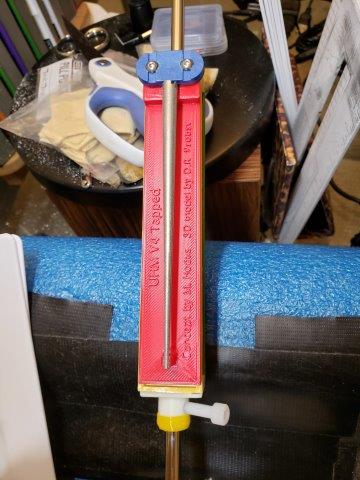

I incorporated a third rolling carriage that is vise-less. This carriage has a square bar and functional guide rods adapted to achieve 0.00º guide rod angle settings to allow for thinning knives behind the edges or parallel refinishing of the knife sides. If the knife edge is clamped horizontal as the vise-less carriage is rolled along under the blade the guide rod angle remains the same. I am working on a W.E. paddle adapter with forum member “airscapes” to hold the DMT Serrated knife sharpeners. I have included a photo illustrating this concept where it will address the issue of individually sharpening knife serration at the same repeated sharpening angle, one by one, as the carriage is rolled along under the knife. I realize there are limitations where the rolling carriage impacts the clamping vises. By re-arranging the vise positions and varying the knife’s clamping method I believe the serrations can be sharpened.

Nice job! You might consider first clamping your blade in one vice, loosen the screws that mount the second vise, clamp the blade in the second vise and finally retighten the mounting screws of the second vise. If you don’t do this, if your vises aren’t perfectly aligned you may deflect the blade when you clamp it in the second vise.
I do it similarly to your suggestion with a carpenter’s square:
Then I’m not reaching and working around a sharp knife edge while aligning and squaring the vises up.

Would like to see more pics of how you have your serration stone mounted to the WE rod, please. TIA
That is whats called extreme engineering! Love the concept Marc and it would indeed make it easier and more precise on my kitchen knives.
Eric here’s some photos. The concept and actual adapter are a collaborative effort between Doug, forum participant “airscapes” and myself. The 3D printed mounts, as designed, printer programmed and printed by Doug, secure a DMT Diamond Sharpener. The adapters are then able to be mounted to W.E. handles.
To use these adapters you need to be able to stay perpendicular to each and every individual serration and portion of the serration as you work across the knife edge along with having the capacity to match the sharpening angle of the serrations.
Even with these adapters there are still many challenges. Serrations vary very much in design and shape as many are proprietary to the knife makers. These tapered DMT diamond stones only allow sharpening of the most basic uniform "u"shaped serrations.
Using these DMT diamond stones, hand-held, on your W.E. clamped knives is probably the easiest way to go.
