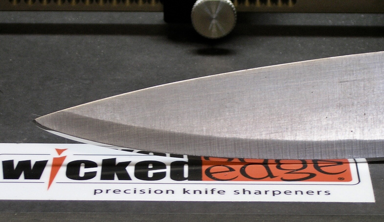

Well, I used the Tormek to get a 20* hollow ground bevel on this thrift store knife. It took about 2 passes per side, to establish the new bevel and go from super dull, to burrs on both sides. From there, I went straight to the WE and set it to 20 dps. I blacked the bevel, took a swipe with 800 grit and it turned out to be a near perfect degree match, with only a very slight amount of hollow. I started with the 400 grit stones and wiped out the black after just a few strokes. Boy, did that save me a ton of strokes. I just have to get over the trouble of taking out the Tormek and setting it up. Here’s a pic of the hair-splitting finished edge…

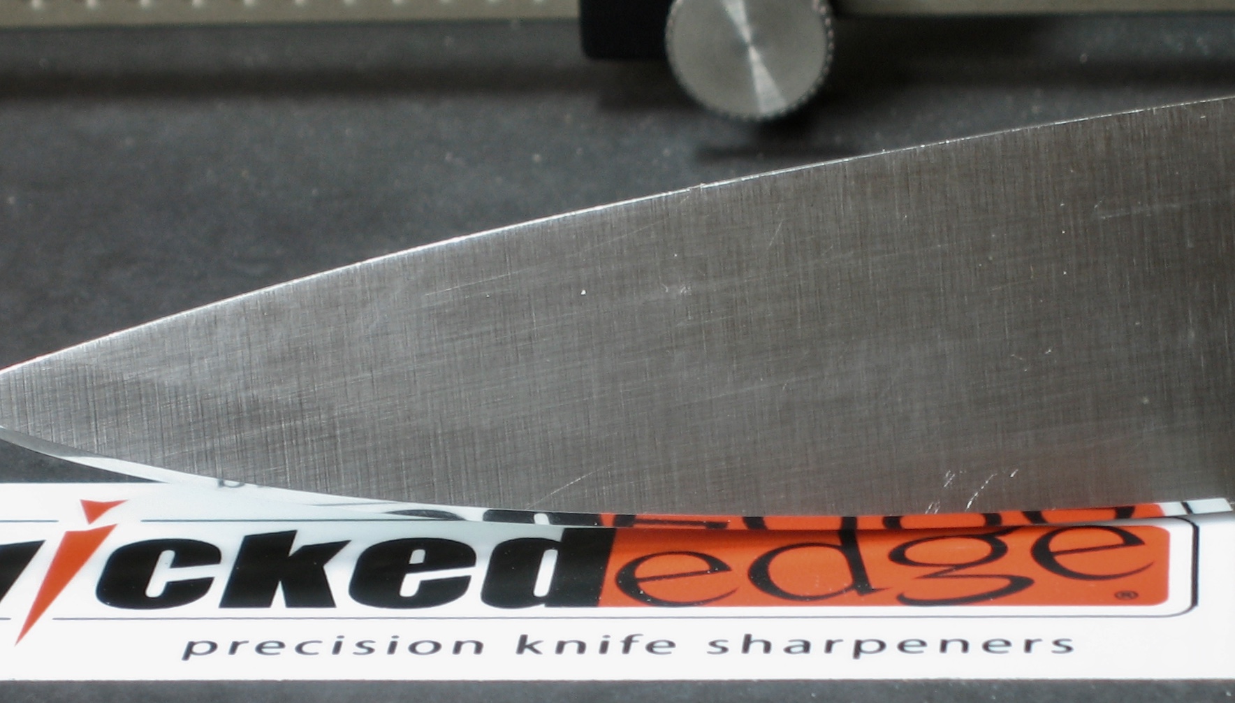

Ok…just because…I went back and hit the edge with 6 and 3 micron films, then stropped again. It really did improve the scratches. Don’t know if you can tell by my poor pics, but take a look…
