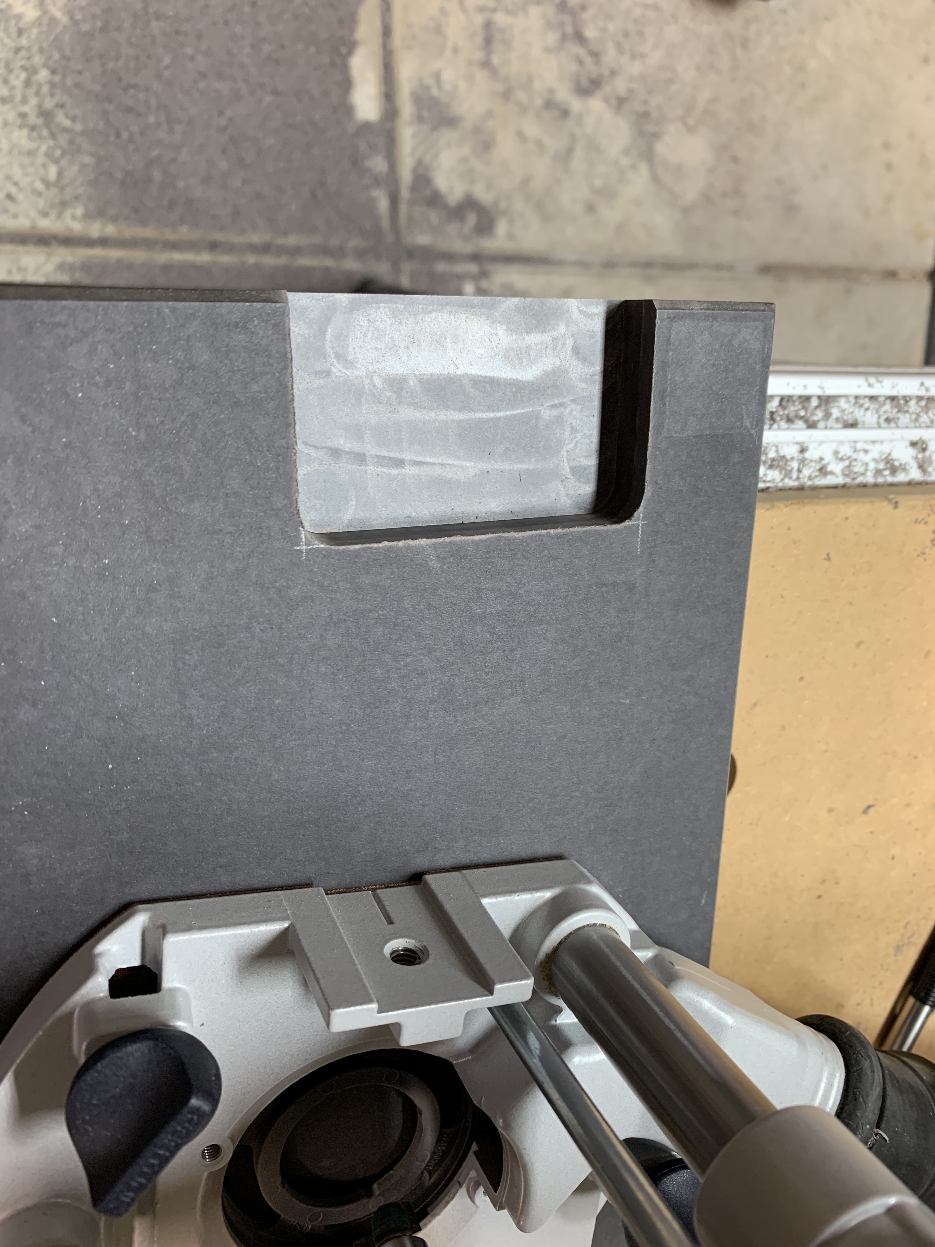

Here’s a pic of the base. I scratched it and the color is thru and thru.
Oops. Here’s the pic…
That looks like Paperstone to me.
Well, thanks for all the help with the base. I was confused, as WE was saying that it had to be either aluminum or quartz. I finally emailed a pic of my base and they confirmed it was in fact, paper stone.
Woodworking bits worked perfectly on it with no issues. I’ve include a pic of the cuts on the underside and the lites clipped onto the recesses.
