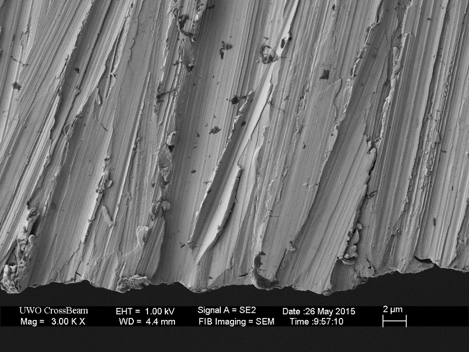

In looking through hypefreeblades I came across this great photo (with more in the link) and just had to share.
http://www.hypefreeblades.com/forum/viewtopic.php?f=4&t=849&start=10
I love SEM images of blades. They really show the plasticity of steel.
Don’t get me wrong…all this theoretical physics of knife sharpening is interesting and makes for fun conversation, but why would you ever even worry about this stuff? Sorry if I’m being an idiot. It’s way beyond the scope of the Wicked Edge Forum helping Wicked Edge users to sharpen knives with their WE Systems. Especially if your knives are taking and holding a sharp edge using the Wicked Edge System. Why would ever think about this stuff? If I had a problem with a knife I sharpened, first thing I’d consider was my technique or how I handled the knife. Then after that and a hole long list of other things, I can’t imagine ever thinking I overheated the edge on a sub-microscopic level to cause edge failure??? Sorry… there’s too many other cool things that actually impact my sharpening experience to consider.
I do love SEM photos, though!
