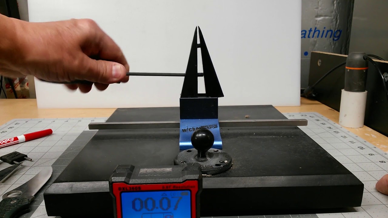

Also, instead of guessing the amount of adjustment to make, can’t I just put the angle cube on the sharpening stone as it’s leaning on the clamped in blade? Wouldn’t this be the angle that I’m sharpening at regardless of all other factors (such as how I’m clamped or how the knife is sitting in the vice)?

A properly zeroed cube will give you the relative angle the stones and the guide rods are to the knife as it rests on the knife. Only after you match the stone’s face flat to the flat bevel then the angle cubes reading is the existing bevel angle. The stone set to an angle of your choosing can be used to grind the knife’s edge to create the bevel at that angle you chose to use. That is “profiling” the knife edge.
