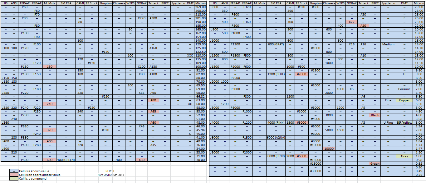

The charts below represent the efforts of some very smart, dedicated people to make some sense out of all the different grit systems on the market today. In addition to the clear confusion represented in these charts, there are concerns about the way different abrasives behave when used to grind metal e.g. 14 micron diamonds plated to a steel substrate produce very different results from diamonds of the same size in an emulsion or paste and applied to a leather strop and ceramic stones with original constituent particles of the same size can no longer be characterized by their particle size once they undergo the sintering or vitrification processes.
The above examples are just two of the charts put together to try to make sense of the various abrasives on the market. They do not take into account:

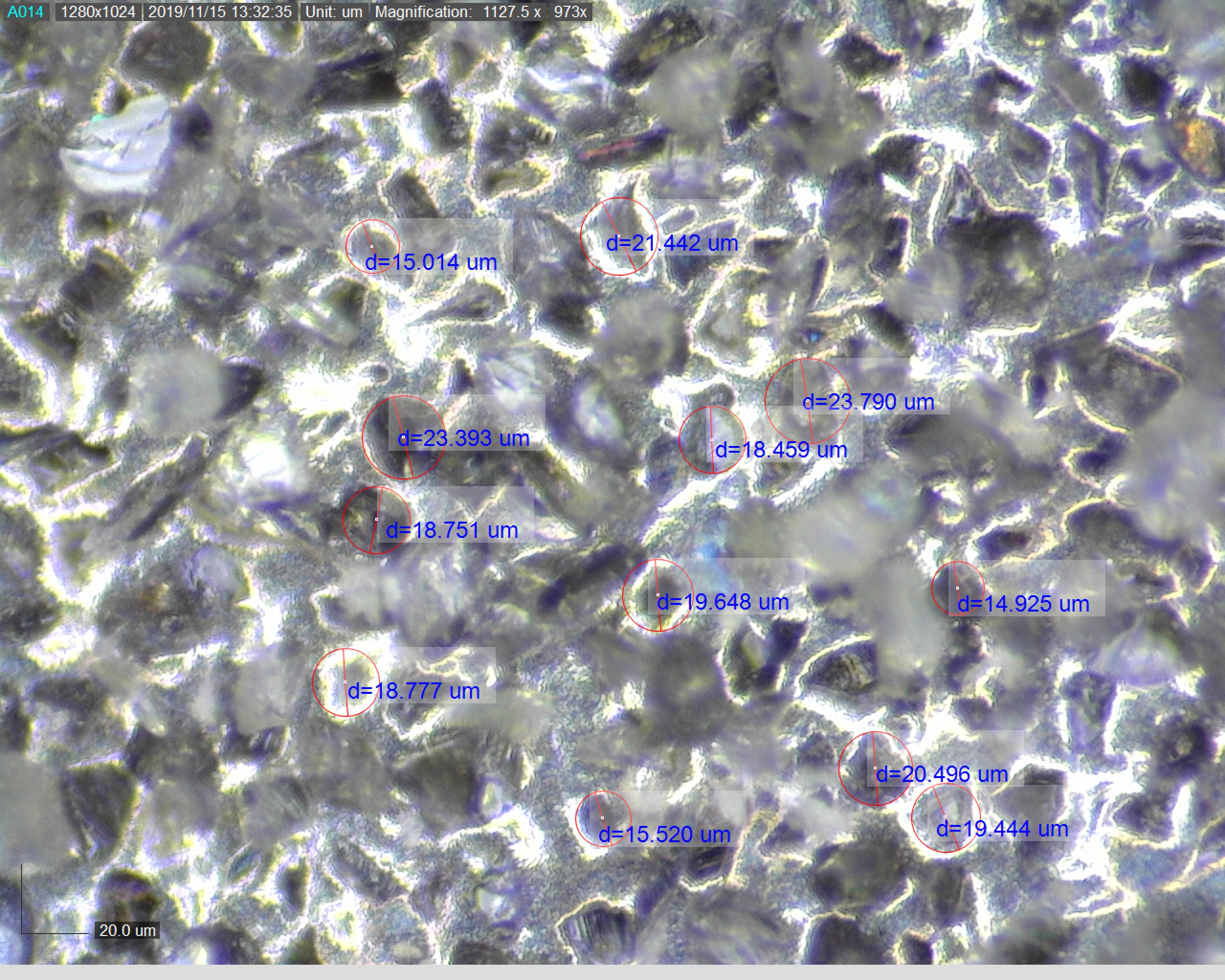

I just completed imaging diamond stones from 800# - 3000# and measuring a sample of the individual diamonds on each stone which I then average:
800# - 19.13um
1000# - 13.68um
1500# - 9.67um
2200# - 7.14um
3000# - 5.04um
*It’s worth noting that there is some variation between sizes depending on how well we can determine the edges of the stones, especially since they are irregularly shaped and it’s not always clear with the diamonds which planes or edges we should referencing.
Clay, I believe those of use with some sharpening experience recognize that the same grit particle size when adhered to a steel plate as with a diamond sharpening stone and applied to a stropping medium through a paste, suspension or an emulsion, or adhered to a plastic film do behave (possibly very) differently. I believe if the grits you list on the grand-unified chart or the gritomatic chart are simply identified to what they are, sharpening stone VS stropping abrasive VS etc., etc., it will be very clear to us what they are.
My understanding of the grand-unified chart is the placement of all those different grits used by all the different companies and sources is how they relate and compare to one another. As a user of mixed sharpening mediums the placement in this relationship is most helpful. I don’t really care how large or small the grit particle is, measured, or named, but more so how it relates to another grit particle called that same size by another source or producer.
A chart that objectively visually measures, grades or rates, and compares all the different grits made by all the different companies by the appearance of the scratch patterns that those grit particles produce, by width, depth and distance between the scratches would be wonderful. It seems dauntingly impossiple to produce such a chart and tremendously expensive for that long tedious process. A chart that only places W.E. grits together, how they relate to one another, would be nice, but not nearly as helpful, to me.
Simply how the new grits fit into this existing grand-unified chart compared to the other Wicked Edge sharpening stones is really what I’m wanting. My concern was, were these grits withheld or not included with the chart because they didn’t fit in with the flow and placement that would be expected or interpolated as suggested by how they were named, in relation to previously marketed and sold sharpening stone grits.
