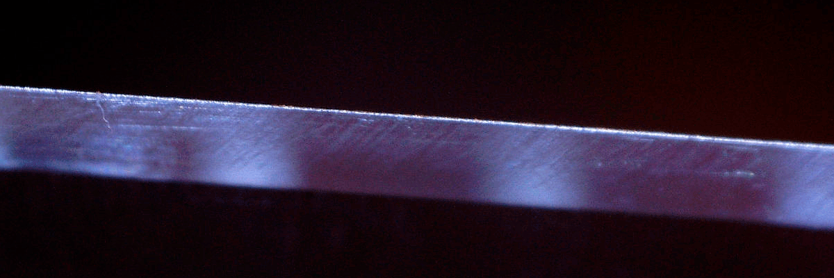

Here’s a photo I took to show the effect of a 0.1 degree change. I use a DXL360 angle cube, which has 0.02 degree resolution. First I stoned the bevel with a 1000-grit diamond stone. I then measured the angle very carefully at 19.96 degrees. I then changed to my 6 micro film (on a brass platen) and adjusted the micro-adjust screw to 19.86 degrees, before stoning for about 15 strokes. In the photo, you’ll see that there isn’t a sharp definition line between the two grits, but you’ll also see that the 6 micron bevel doesn’t quite reach the edge, which is the point of this discussion. In all honesty, I don’t think that 0.1 degree normally produces this result and that even my set-up has more “slop” than this and that the real difference might be something greater. https://tcmeyer.smugmug.com/organize/Wicked-Edge-Related-Stuff/Microphotos/i-WprLfBm
In my first comment above, I suggested that “An error of just over one tenth of a degree” would produce this result, so I tried to produce the effect by staying with the 1000-grit stone, first at 20.00 degrees:https://tcmeyer.smugmug.com/organize/Wicked-Edge-Related-Stuff/Microphotos/i-nzxHqB7
Then at 19.85 degrees:https://tcmeyer.smugmug.com/organize/Wicked-Edge-Related-Stuff/Microphotos/i-9sN9Tmh
Then at 19.70 degrees:https://tcmeyer.smugmug.com/organize/Wicked-Edge-Related-Stuff/Microphotos/i-fWDrLK4
In this last photo, the 19.70 stoning almost erases the 19.85 scratch marks - perhaps I took too many strokes with the last stoning. You’ll note that I applied a sharpie mark to let me photograph the same area and you can see scratches from the 19.85 stoning still there in the last photo.

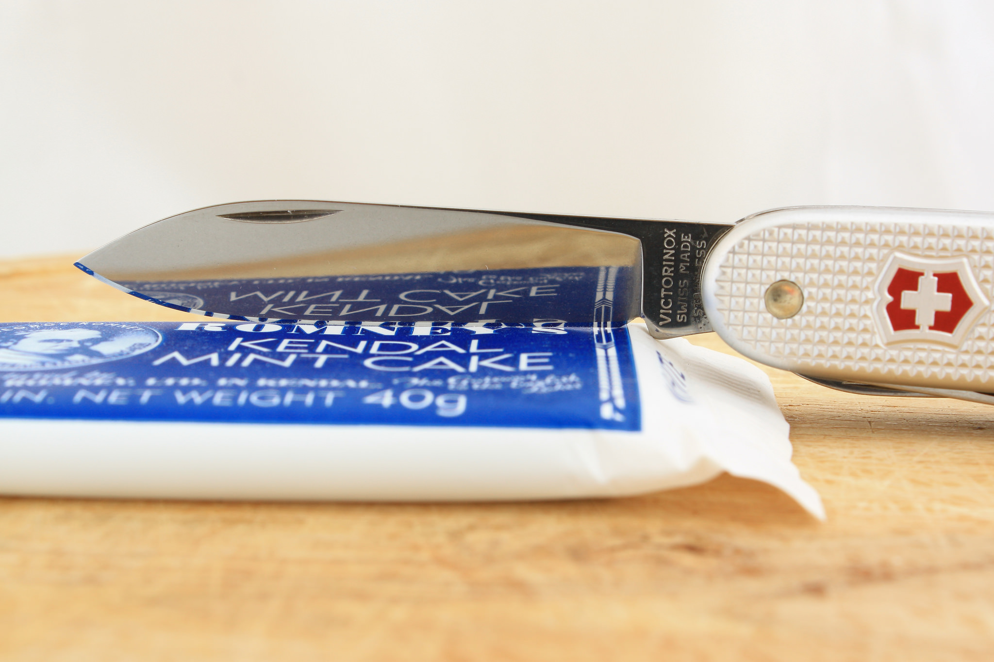

I fully agree. I don’t think a bit of play is any problem at all. For example, this Victorinox knife was sharpened on a Lansky which I think we can all agree, has a lot of play :slight_smile:
Original photo here: https://www.flickr.com/photos/fvdk3d/24869504791/
It has a very nice polish and it is as sharp as this Victorinox which was also sharpened on a Lansky
I love my WE with all the bells and whistles but learning how to use a particular system and how to get the most out of it makes more of a difference than 0.1 degrees of play.
just my $0.02
Frans

Below is reposted what Tom wrote. I just replaced links with images for easier visual reference. It is a great post. Tom, if it is not OK, let me know, I’ll remove the post.
In this last photo, the 19.70 stoning almost erases the 19.85 scratch marks – perhaps I took too many strokes with the last stoning. You’ll note that I applied a sharpie mark to let me photograph the same area and you can see scratches from the 19.85 stoning still there in the last photo.
Tom, your pictures are absolutely awesome proof that 0.1 degree really makes a HUGE difference. I placed order for DXL360S immediately. Thank you very much!!!
Now I can understand reason why sometimes people complain that bevel can be mirror shiny, but edge is not sharp. You are right, if angle changed a tiny bit, stone may not reach the apex. One can save a lot of work with less strokes if angle is precisely fixed.

Mark: If you use the standard WE handles ( I prefer to call them blocks ), with each transition to finer grit you’ll be pretty sure of hitting the apex. Clay called it a “happy accident.” Each of the blocks is slightly thinner (from face to face) than the previous pair. This means the next pair will have a higher angle than the previous pair. I think it was a result of the diamond matrix being somewhat thinner with each finer grit. This would carry the principle not just to the handle, but also with the grit change on the same handle. The distance from bore centerline to the 1000-grit face would be less than the distance from the same centerline to the 800-grit face. The differences are certainly small in terms of angle change, but consider what would happen if the opposite occurred: with each step up in fineness, you’d be less sure of hitting the apex.
The value of measuring small angles accurately is two-fold. First, it allows you to adjust accurately where you have a handle whose centerline-to-face dimension that falls outside of the previous pattern. Careful use of the VSTA adapters can serve much the same purpose. The second advantage is psychological - assurance that the effort you are investing in a particular knife will not be wasted.
Before everybody runs off to buy DXL360’s, please note that this is not my intent. I wanted only to show that 0.1 degree errors can, in fact, produce a bad result; the user who can’t seem to get his knife any sharper. That said, DULLEDGE, thanks for putting the photos right. And you’re going to really like your DXL360S.
Again, I’m not trying to preach the logic of my modifications, hoping to convert any sinners. I’m just an OCD guy trying to demonstrate how angular errors can produce less than ideal results. As long as the Wicked edge system has been out here, there have been users who can reliably achieve edges every bit as sharp, or sharper than I can, even with my dead nuts precision. My modifications were done mostly as an exercise of curiosity and partly to assuage my doubting mind. I wanted to go to diamond film-on-glass and believed (wrongly it seems) that doing so would require a higher level of precision.
As an exercise, place your 1000-grit stone against a blade in your WE vise. Apply a normal amount of pressure with your grip point about centered on the handle. Attach your AngleCube to the upper part of the handle and observe the reading as you raise the handle from below the knife edge to a point above the knife edge. What you see is why I recommend keeping your grip point below the knife edge, but it also tends to tip the stones away from the apex.
