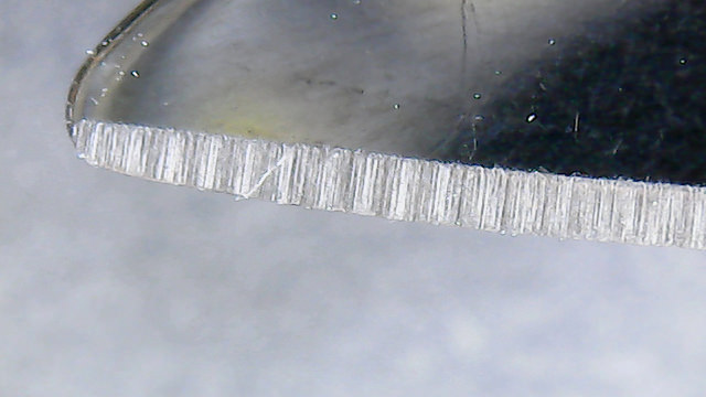

Here are three photos of a Victorinox knife.
The original factory edge under magnification:
The same edge re-profiled and polished with 1 micron lapping film:
The edge as seen by the naked eye:
Frans
I think Frans made a very good point. If you’re out for a good edge and particularly out for a mirror edge, a good loupe/microscope is almost indispensable.
