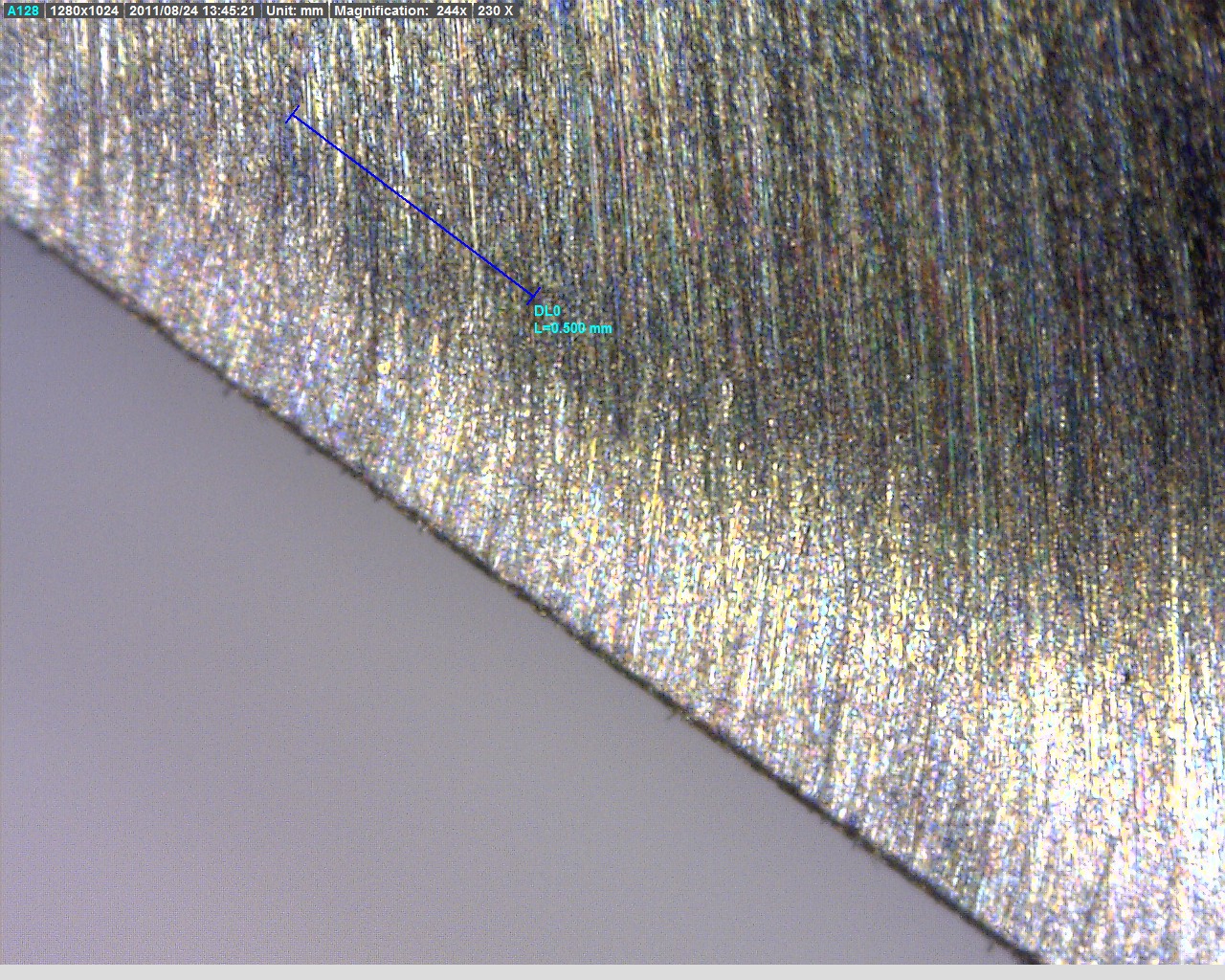

After a few days at other tasks, I’m finally able to start up the progression comparison again. The next knife to sharpen is a Fällknieven TK2. The knives come very well sharpened new with a nearly complete Scandinavian grind. There is a very fine micro-bevel so it’s not a true Scandi, but it is very close. Below is a picture of my F1 that has not been sharpened yet, showing the tiny micro-bevel:
Zoom In - 230x
Leo’s knife has been sharpened with a series of bevels or facets and is on the way to becoming convex. Here is a photo of the knife as it came in from Leo:
Zoom In - 230x
Next I’ll get to work sharpening this knife. I’ll use the Shapton stones for this one and the Choseras for the Fällknieven folder.
I started sharpening this at 16.5 degrees with the 220# stones. I used an inclinometer to measure the actual angle since the Shapton stones are thicker than the stock Wicked Edge stones and give a more acute angle. The settings on the Wicked Edge sharpener for this knife are:
Angle - 21 Degrees
Depth - Top Holes
Alignment - B
Here is a picture after flattening the bevels out:
Zoom In - 230x
Approximately 90 strokes per side. Elapsed time: 1.5 minutes.
