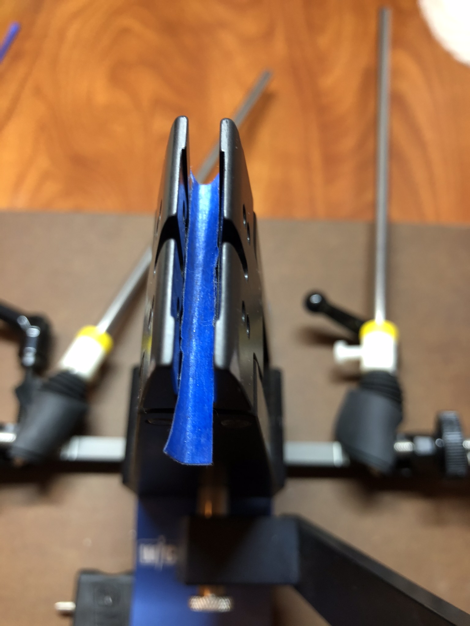

I did use bicycle dry lube on the “cam”. Doesn’t seem to make any great difference. In lieu on the small piece of foam, I use a piece of the blue tape, folded back on itself and trimmed to fit between the jaws. Works great! Better than the foam.
