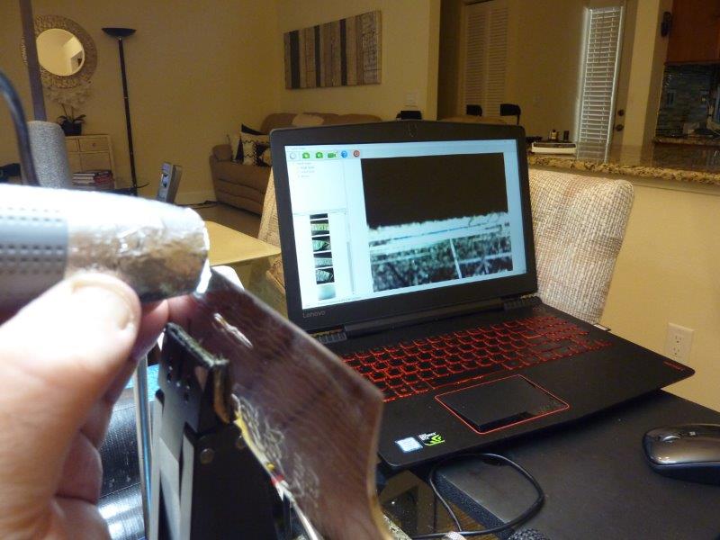

I have that same Carson scope and I totally agree with TC; the adjustment for the focus is much too easy to disturb. If it would stay put I’d probably use it more often.
I have adjusted the focus rings on my scopes to fine focus on the high power range with the scope positioned against the knife’s edge, on the bevel side, where I use it when viewing the bevel. Then I wrapped the focus ring with silver aluminum tape to hold the ring in position. Any fine focus adjustments from that point I can make simply by slightly lifting one edge of the scope’s shroud off and away from contact with the knife’s surface. It only takes a ,tiny, tiny shift or lifting of the shroud. I still have the shroud contacting the steel I just rock it away so there’s a minute gap on one side of the shroud. This slight slant of contact increases the focal length and focuses the image. The tape holds the ring positioned and allows me to hold the scope around the taped ring without effecting the focus setting. It does take a little care and may be tedious to get the focal ring taped into position, the first time. Since I have taped it I have used the scope taped just like this for years now without having to adjust the focus. I do have the focus locked in on high power by choice.
I might have to do that to mine.
TC… thank you!! & Marc…brilliant!! I am going to try that with mine. I have the same problem and that will speed up the process. You guys are all a wealth of knowledge.

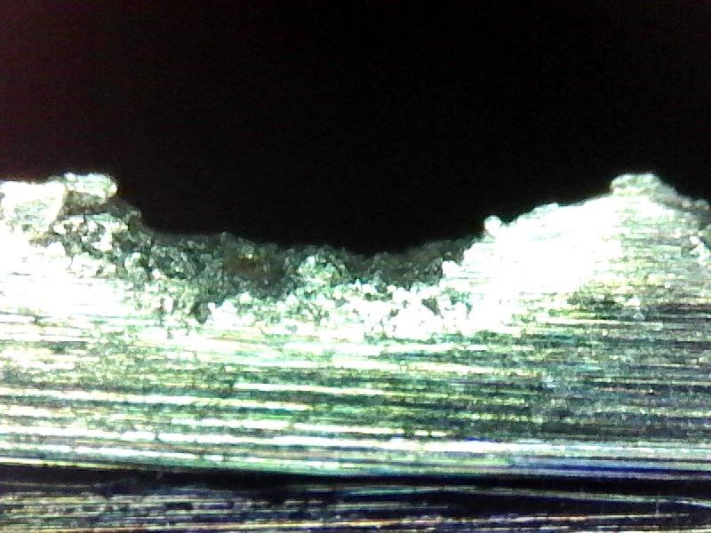

I’ve been sharpening four fish cleaning knives this guy has been using a “V” style pull through sharpener, with. The sharpener destroyed the edges on these knives I have previously sharpened, well. Here is some damage it had incurred. You can see the horizontal scratches and the steel tear out, from the carbide pull through sharpener:
I started with using the 50 grit diamond stone horizontally, working with a scrubbing stroke along the edge length heel to tip to heel. This photo shows the flattened edge still existing after I changed to using up-down scrubbing strokes to re-profile the damaged bevel back to 18º. Even after scrubbing with some pretty good applied force, for some time, the vertically flattened edge from my horizontal scrubbing that I had used to remove the deep damage, still is present. The point I’m making is as aggressive as we think or know this 50/80 stone pair is, it still requires some time and effort to remove and profile the edge on a knife that requires this grit for it’s repair and restoration.
With continued up-down scrubbing, alternating back and forth, side to side, I was eventually able to apex the edge as shown in the last photo.
The 50/80 diamond stone does definitely have a place in a sharpeners arsenal. This is 4 knives in a row I’m using it. I believe the 50/80 is broken in, now. I have been using it for a while now, months, regularly. From looking at the ragged scratch pattern, you wouldn’t think that is broken it. The aggressive scratches are scary. Don’t let that fool you. These stones have there place. I wouldn’t want to try to sharpen a knife with this damage without it. The only other recourse is a belt grinder.
Last is the end results of the 50 grit. An 18 dps profiled bevel. Now to move on.
