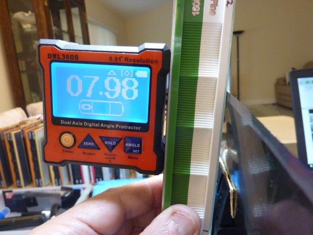

I just looked at some pictures I took of my modded/ upgraded WE130 with the riser block. I am able to achieve angles down to around 8º per side with a tall Japanese Chef’s knives, with only the riser block, not with the low angle adapter, (LAA).

Marc. Thanks for the pictures and info. I’m going to put mine together and see what I can get. I’m thinking knives like a Santoku and Nakiri I will be able to do the 12 dps (I actually only do my Nakiri down to 14 dps so certainly no issue there). Gyuto probably fine also. Not so sure on a Petty.
