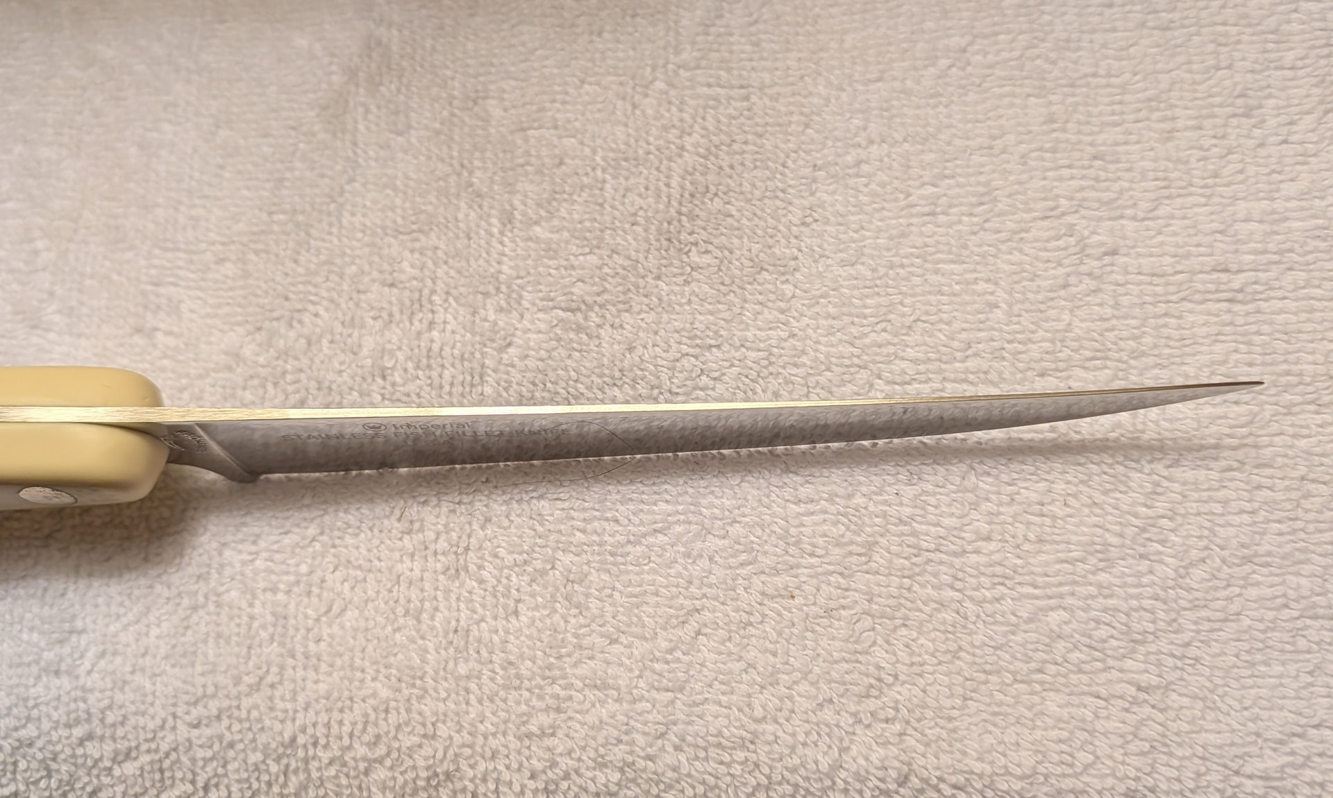

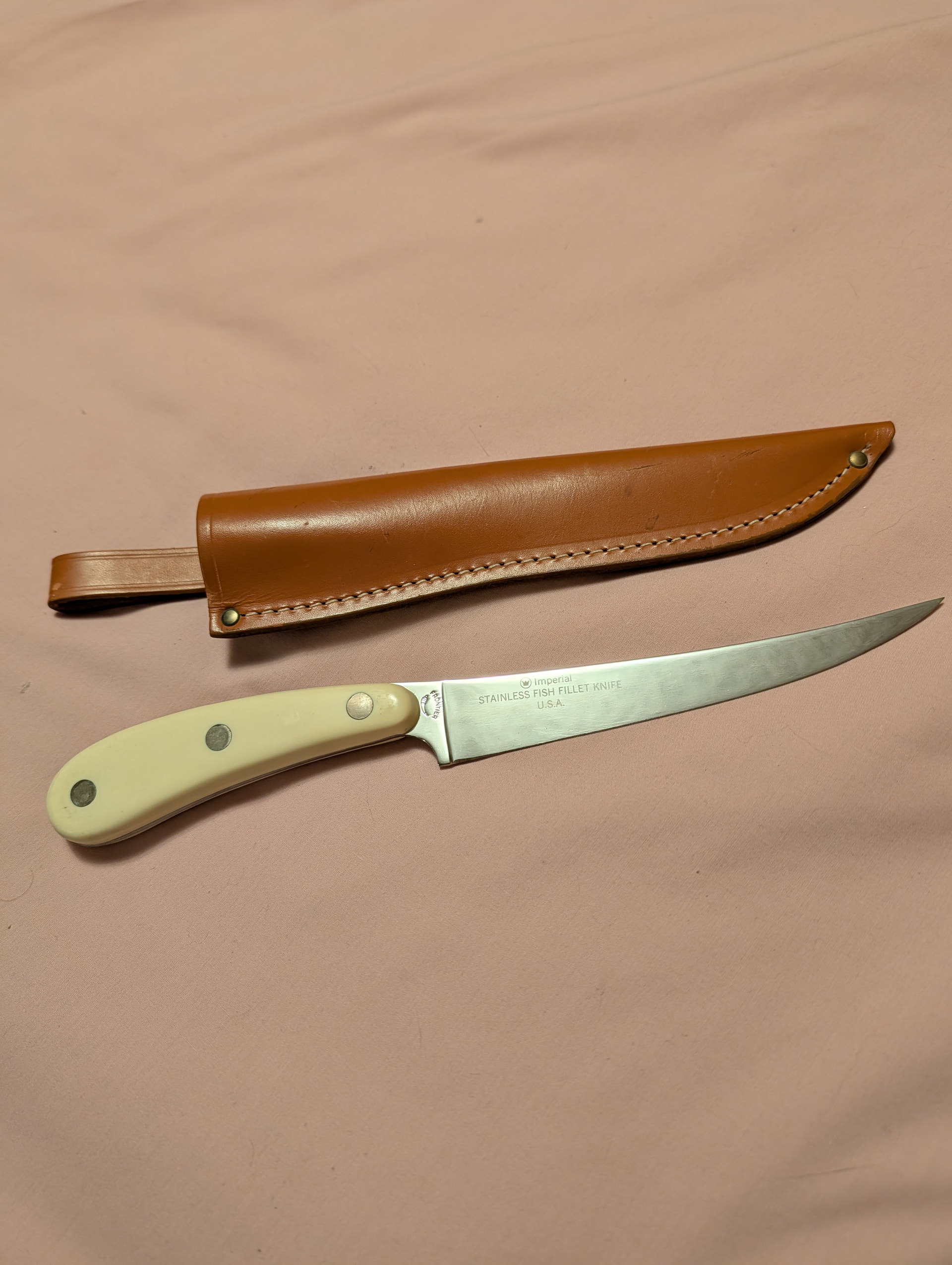

Thanks for replying, Matt. I was thinking 18 degrees but you may have other ideas. Here is a pic of the knife.

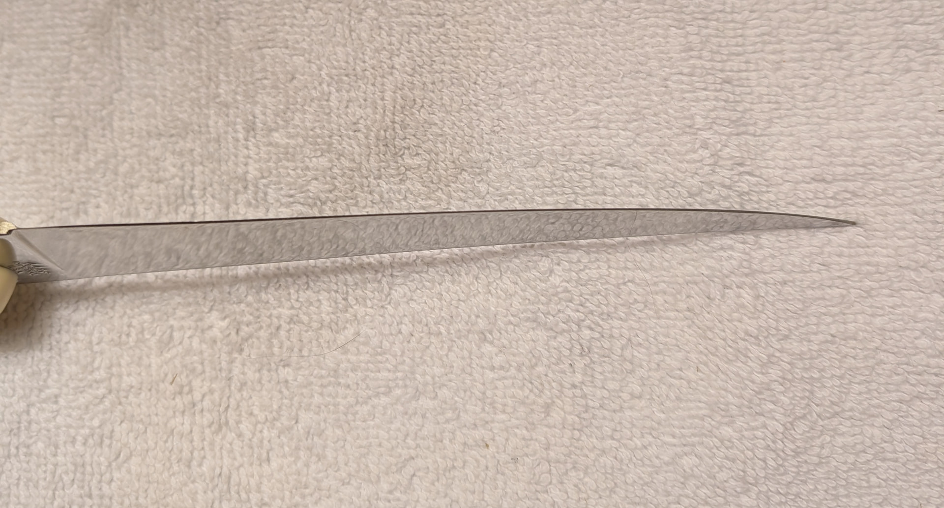

Two more pics that might help, Matt. Thanks. -Clif
Hey Clif
Thanks for the photos, and beautiful knife! Since that knife is so narrow from spine to edge, you’re going to run into clearance problems no matter what vise you use (our sharpeners or otherwise). I do recommend the Low Angle adaptor, which you already have, and I’d say that you should use the most narrow angle that you can, while still clearing the vise. And remember, the angle markings on your sharpener are going to be off quite a bit when using the low angle adapter as it changes the geometry of your sharpener.
