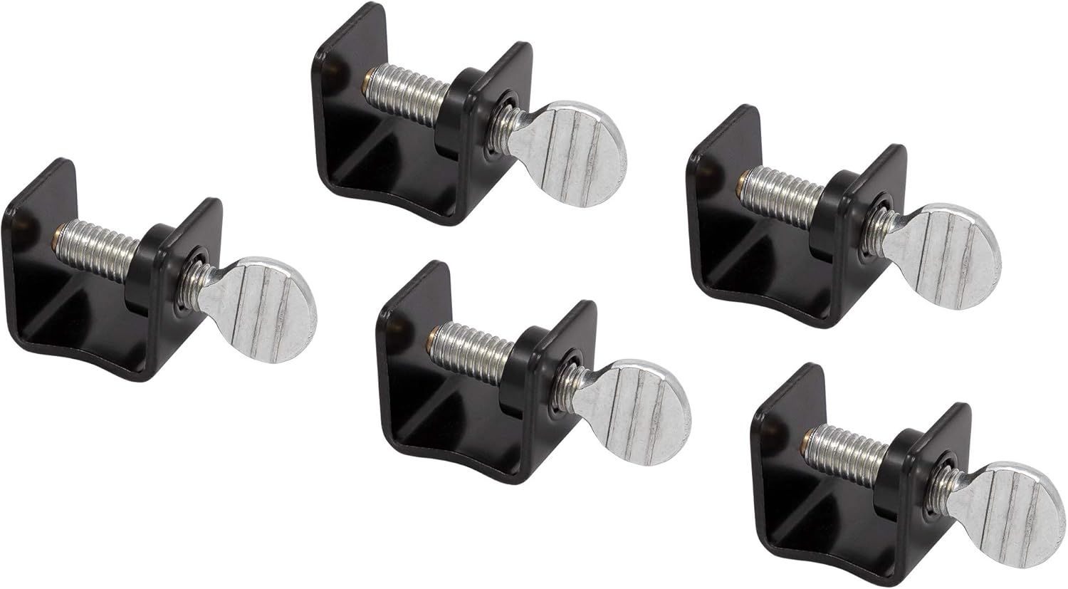

So I mentioned this in another thread … looking for something that would be very small so as to not get in the way and yet be functional. This results from experience of myself and others (see Clay’s post here). So Pinkfloyd pm’d me an idea of these
They look like they would be PERFECT if I ground off that lip and used some sort of non-slip cushion material, however, when I looked them up on Amazon they appear to be cheaply made and have poor reviews.

yeah I like those curtis… I was just wanting something w/ 2 flat faces to prevent scratching… but come to think of it these couldn’t be hard to make!
pinkfloyd, nice!! They may work if you flipped them around or ground off the points… but I’m wondering if I could fabricate some w/ small screws to almost mimic a WE vise?
