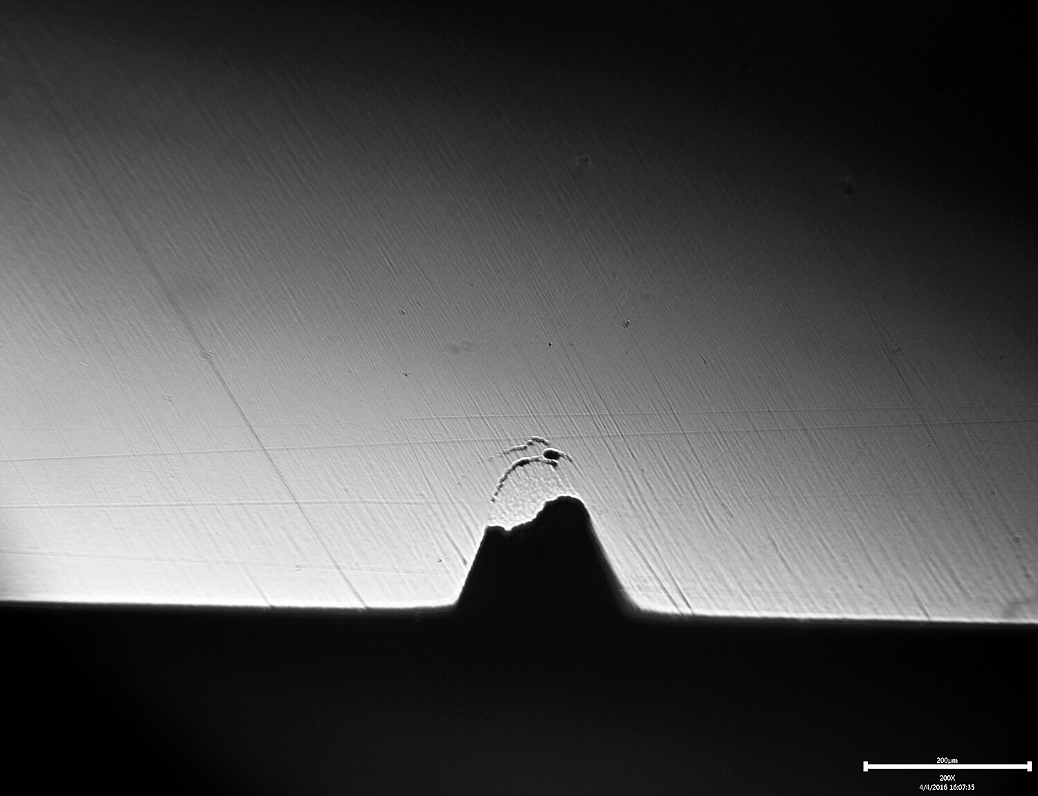

I was messing around with some different grit progressions and testing some new emulsion formulas (very promising!) and I decided that I wanted to make a permanent mark on the blade so I could be sure I was continuing to look at the same spot under the scope. The field of view is so small at high magnification that it’s easy to get lost along the bevel and never make your way back to a feature you were studying. I took my EDC and set the edge on the edge of the utility blade I was working on and gave the EDC a little tap on the spine with a diamond stone block. It definitely made a mark:
The above image is at 200x
Here it is at 2000x
Again at 2000x. You can clearly see fracturing of the steel above the area where the large chip is removed.
Another look at some fracturing.
My sense about the utility blades is that they are not overly hard, but rather designed to be tough, which is why the fracturing was a little surprising. You can’t see the fractures with the naked eye, or even a good loupe. It makes me wonder how often blades do have micro-fractures like this that go undetected and lose their edge in that area.
