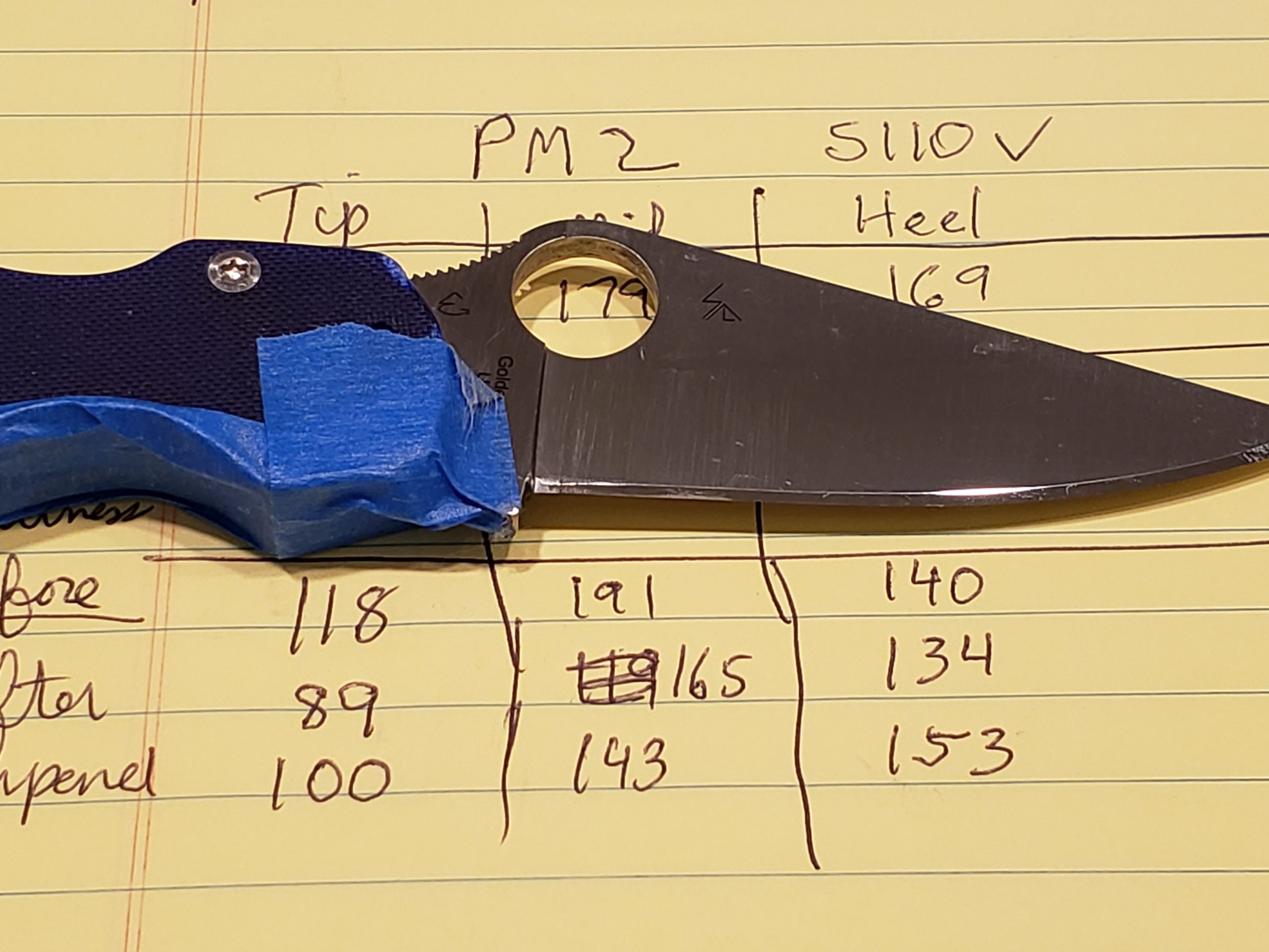

Here are the Pics I sent MarcH so he has a reference on how I’ve been clamping the S110V PM2. I didn’t sharpen it, I just clamped it for the reference pics.
The blue lines are where I took the BESS measurements. The knife has been in use for over 2 months since the last touch up.
Ed K.
I just finished Ed’s PM2. I sharpened it to 17º per side, just as he had last done. I used Shapton Glass Whetstones, (these are no longer available). The progress: Shaptons 500/1000/2000/4000/6000/8000. Then W.E. DLF’s: 3µ/1.5µ/1.0µ/0.5µ. Then leather strops with 4µ then 2µ W.E. diamond emulsions.
Here are the BESS Scores and photos: (three tests per blade section, tip, mid, and heel),
My sharpening impressions: I could definitely feel the hardness of the S110V Stainless Steel. It did take some effort with the first 500 grit Shaptons Stone to remove previous edge damage and profile the bevels to 17º per side. I did not find the steel to be too chippy, but this is why I use the Shaptons on these hard brittle steels. The Whetstones are able to sharpen steels without it chipping out whereas I find the diamond stones can’t. I was pleasantly surprised as the apex leveled and smoothed out with each subsequent finer grit. Even still the steel does keep a toothiness to it.
I used scrubbing strokes to start with each sharpening stone. Then I followed that with alternating side edge leading strokes. I did spend quite a bit of time with each grit looking to achieve the best results I could. I find it’s better to do more work, spend more time and give more attention then to not, to achieve the final results expected then to wish I had.
The DLFs did bring out an impressive mirror polished bevel. The last stropping phase did smooth off some of the grab of the just sharpened knife edge, leaving an edge that easily sliced newspaper with a whisp. I will be curious to see how well this edge stands up to EDC use.

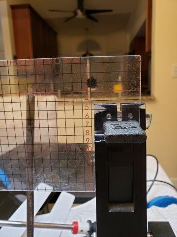

With the advanced sharpening guide are we to let it dangle as Clay has here or are we to straighten it so it is level with the jaw edge of the Gen 3 ?
An alignment guide is used as a position referencing tool. So it’s used in a repeatable orientation. To insure the guides orientation is the same each and every time I use it, I align a horizontal gridline so it is parallel to the horizontal top of the vise jaws. I also align a vertical gridline so that too, is parallel to the vertical edge of the vise. It may be helpful to use a piece of tape to hold the alignment guide stationary in that aligned referenced position while you are finding the desired position to clamp your knife.
Thank you as I was wondering why Clay let it fall to a slanted position using the top holes I understand horizontal alignment with top of vise but how do you do vertical since it is slanted and not rectangular?
When I use the AAG to get my reference points I look at it from the left side.
This left side view allows me to align the AAG’s position relative to the vise for my referencing position…horizontal to the jaws and vertical to the front of the vise. As you see the horizontal gridline is parallel to the jaw line and the vertical gridline is parallel to the forward flat vertical edge of the vise.
When I record a knife’s clamping position in my sharpening log, I indicate which pin hole pair, the upper or lower pair, the knife was resting on and whether it rested on the front pin, the rear pin, both pins or neither pin. This notation also tells me where I had placed the AAG, because it is held in place in that same depth key pin position.
