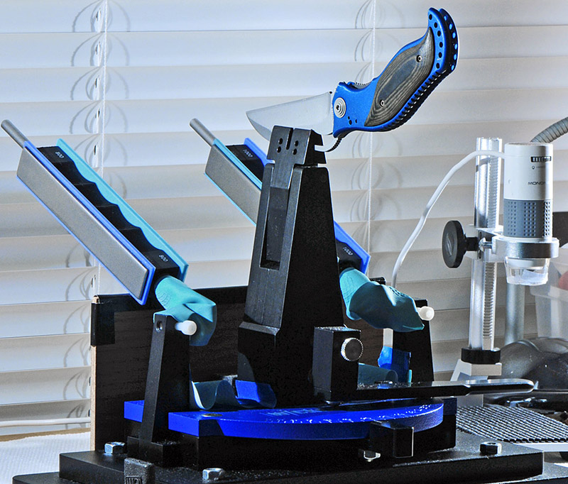

And this is the blade that tasted my flesh (which I finished sharpening right after I got back from the ER!!):
If you look closely at this picture, you will see that I had been using the WE for a while at this point, as the picture shows that I had already upgrade to the modified paddle arm collars.

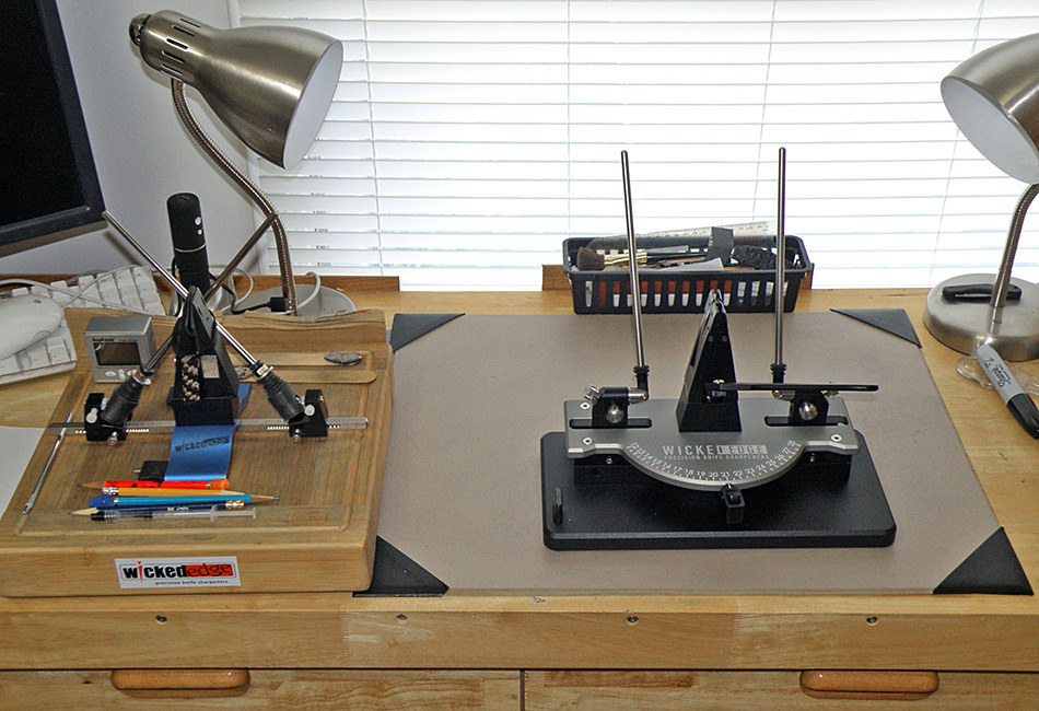

As you’ve read in my journey post above, you know that when I purchased my Gen 3 system, I decided to keep my original, 2012 WE sharpener. My reasoning still remains valid today and it is a decision I will never regret. But more on that in a bit.
Since my initial post, I have upgraded my Gen 3 with the newest version cam-lock vise, as well as a set of jaws for thicker blades.
While I was skeptical at first … with regards to its improvement in clamping over the original Gen 3 vise, I quickly found it was well worth the upgrade price. Specifically, the tension adjustment lever totally eliminated any potential blade slippage in the vise jaws, regardless of blade thickness or geometry. The other thing I did was to remove the storage bin under the sharpener. This brought the unit a little lower and made sharpening more comfortable for me. Those who have done this know what I mean.
I added the 2200 / 3000 grit stones into my sharpening progression (depending on the knife I am going to sharpen). So far, they are working very well and are pretty much broken in. I have also eliminated the super fine (1200/1600) ceramics from my sharpening progression. I still use the micro fine ceramics … but not so much for polishing. I find that they still do a very good job of cleaning up / refining the apex with just a few edge leading strokes per side.
Now, back to that original 2012 WE system. As I originally said, as much as I love the Gen3, there are just some times I find it unsuitable for a particular knife. Here is a case in point … my Spyderco Centofante Memory. (And forgive me, updating this post was not on my mind when I was sharpening it, so had to take some pictures today, after the fact.)
The Centofante Memory was, as far as I am concerned an underrated knife. Even after it was discontinued … huge numbers were still available. Now, I bought mine after they were first released in mid-2012. Unfortunately, it came with a horrendously sharpened blade. It was very sharp … but with an uneven/wonky edge and overall blade geometry. I put off resharpening it until it really was necessary, because, even though it had a sharpening notch … it had very little exposed ricasso. The sharpening notch and sharpened edge pretty much joins up with the titanium handle. So, I knew I would have to take the knife apart and sharpen the blade removed from the frame. I first tried to sharpen it in the Gen3. No dice. Blade geometry was so wonky that micro adjustments would not come close to letting me get to an even edge bevel on each side without serious trial and error shimming of the left side. Felt it would be much easier to just mount it in my original WE. Here is a picture of it mounted with one shim on the left side:
One shim was needed in order to obtain a 19 dps angle without contacting the vise on the left side with stones and strops. Notice the big difference in arm positions left and right. That is the beauty (and, at times drawback) with this version … the ability to adjust each arm separately. As I said, could not have accomplished this without trial and error shimming in the Gen3 … and still might not have been able to achieve the same results. Anyway, the original WE produced a consistent 19 degree edge. VG10 is pretty easy to sharpen and easily passed HHT 3 for sharpness.
So, for me, will never regret keeping this original WE system. I have over 200 knives in my collection and every once in a while, run into a situation where I prefer to use the original over the Gen3. That said, there is no better sharpener on the market than the WE … regardless of which WE system you chose.
