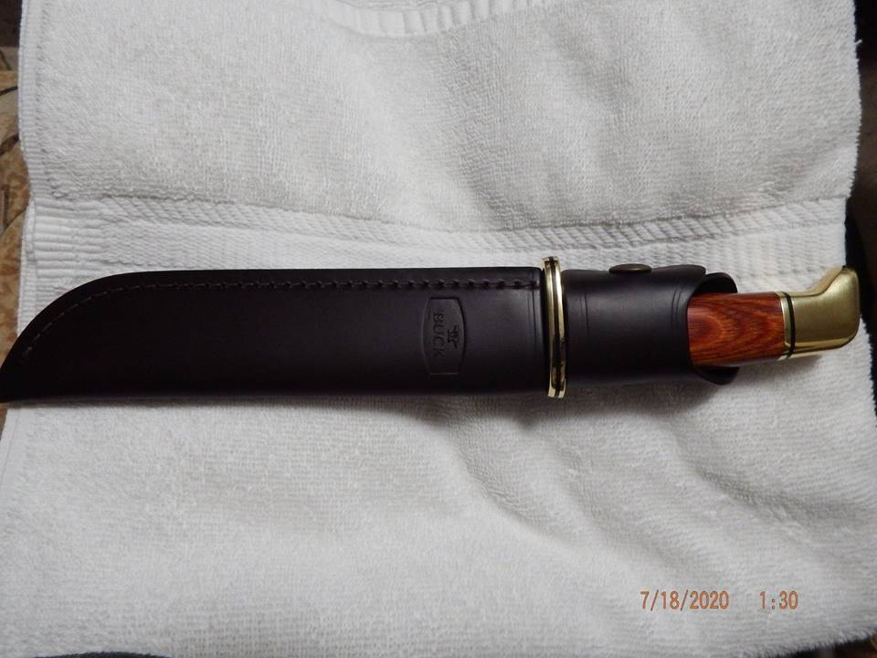

My new Buck 120 General
Hello guys! My new Buck 120 General just came home yesterday. It has the Cocobolo DymaLux handle with a brass guard, pommel and a decent sheath. It is hair shaving sharp! It wasn’t easy but I trimmed my beard a little bit with it. The clip point worked pretty good trimming around my mustache.
I can’t wait to get it clamped up in my WE130. But there’s something in me that doesn’t like sharpening a knife that’s already sharp. I think it is a great deal for $99.95.

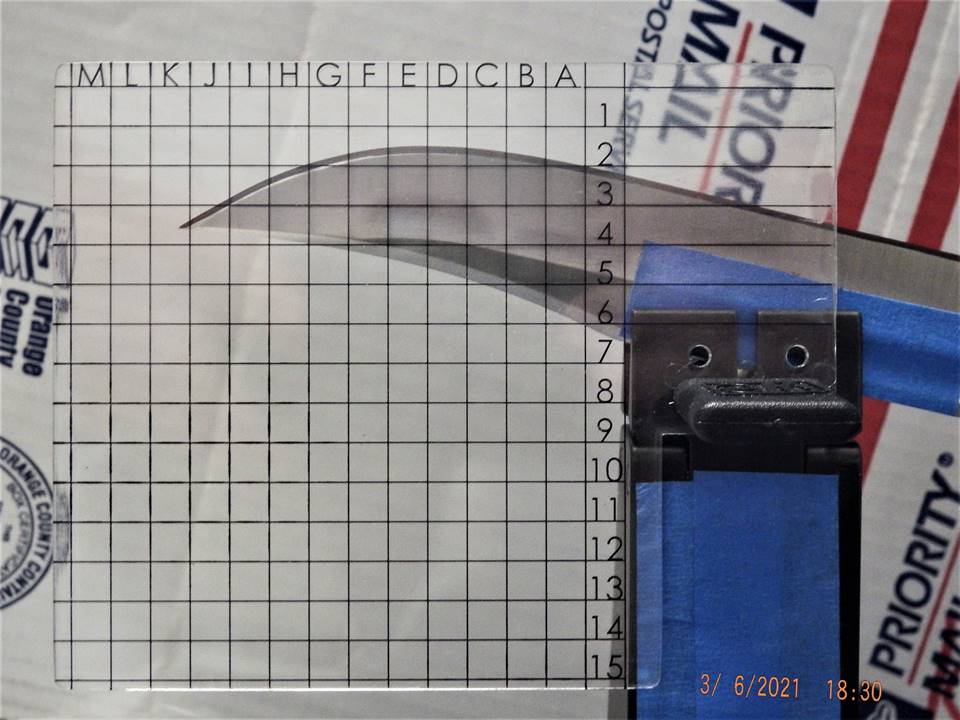

Hi there 000Robert. That is a nice looking knife. When you do get around to clamping it let me know how you work around the blood groove. the reason i ask is i have been trying for ages trying to clamp my Buck 119 which also has the groove. The vice does not have enough steel to grip properly if you clamp over the groove and if you try forward of the groove the tip is way to low to be practical. If you already have any insight to solving this issue could you please let me know, thanks.
Well, it turns out that I made a mistake on my Buck 120. I have a photo of two different ways that I clamped the knife and I don’t remember which one that I used. Normally, I delete the photo of the setting that I don’t use, and only keep the photo of the setting that I keep. But I forgot to delete the setting that I didn’t keep on my Buck 120.
So, I’ll show both photos and you can see which setting works best. Or you can adjust it some if you want to.
Thanks for that 000Robert. Don’t ask me why but i am going for 15 degrees which means i have to use the top holes as a minimum otherwise i am grinding my vice (I wish they still made riser blocks.). As it is i found an old chamois cloth and used that instead of tape, it gives me the grip needed to stop my knife from moving plus i can use it over and over. The photos are appreciated though for some of my other knives in the future, once again thankyou.

You’re welcome. I sharpened mine to 20dps. I just clamped my Buck 120 in the top holes of my WE130 without tape or anything and the clamp holds it good and tight. Most of the time I use tape or pigskin just to keep from scratching the blade, not for holding power. The Wicked Edge clamps hold good without tape or anything with most blades.
Edit: And I even forgot to wipe the oil off of it before I clamped it!
