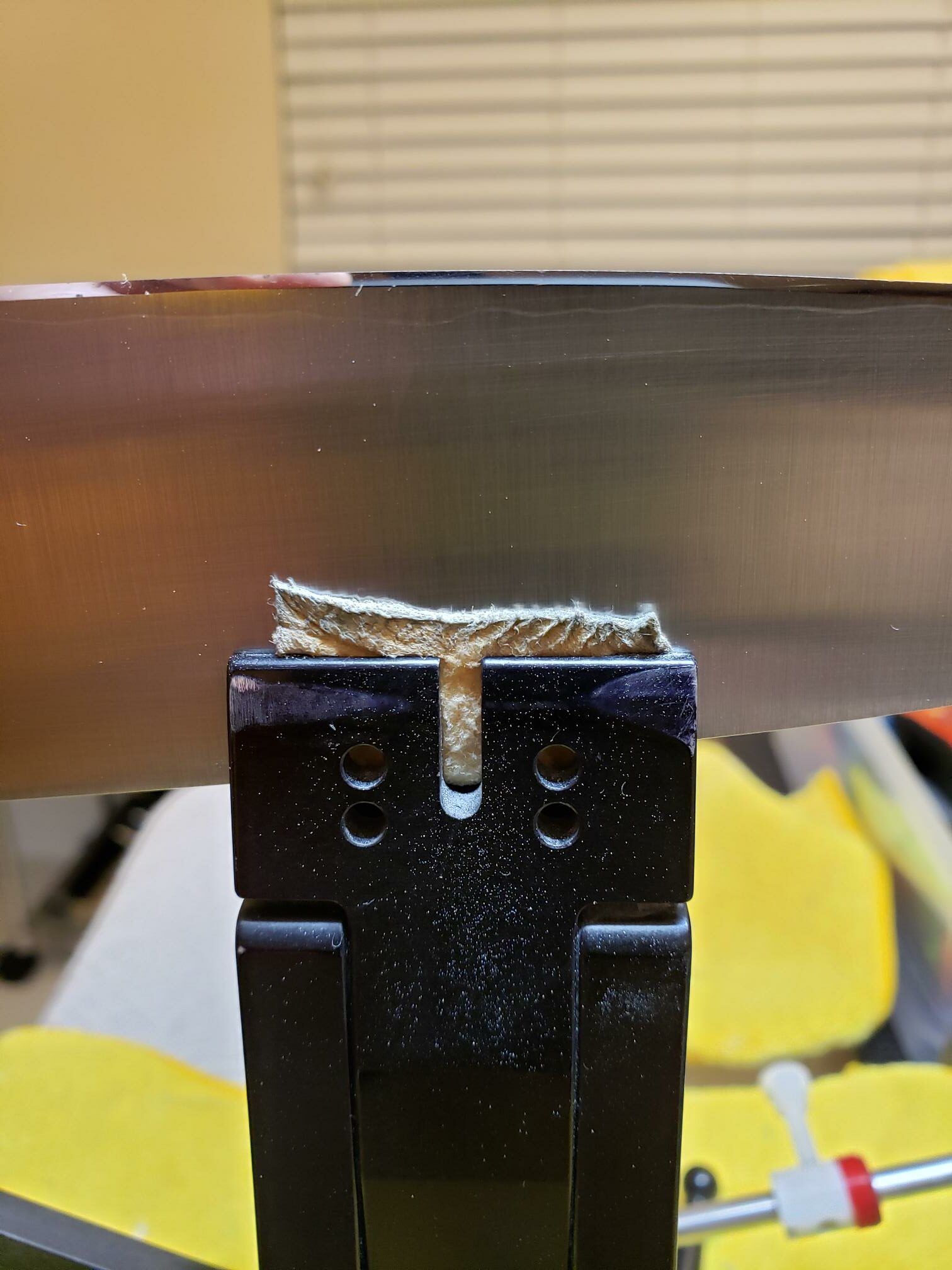

Just a quick question…I generally wrap my blade with blue painters tape to help prevent marring of the blade. Seems to work most of the time but, every now and then a knife will move (or slip) if the blade is not a “good” match for the vice. In some cases you could argue the tape is creating a slick spot between the vice jaws.
So…is this a pretty common practice or is there a better way?
I think I read that someone suggested mole skin stuck to the vice jaws?
Thanks!

I like to use a small rectangular patch of real leather chamois cloth. I bought a chamois cloth from the Walmart auto aisle probably 6 or more years ago. The leather chamois is used to dry cars after washing them. I’ve been cutting on this same cloth and still have like half of it left.
I wrap the dry rectangular patch around the knife spine where it seats in the vise jaws. It compresses under clamping pressure and holds the knife tightly and securely while protecting the steel from marring.
Wicked Edge now sells paperboard shims that have worked pretty good for me. I sometimes use pigskin also.

I picked up a chamois today for 10$ and gave it a try. I believe this is a much better option over the painter’s tape. It seems to grip the blade tighter than the tape.
