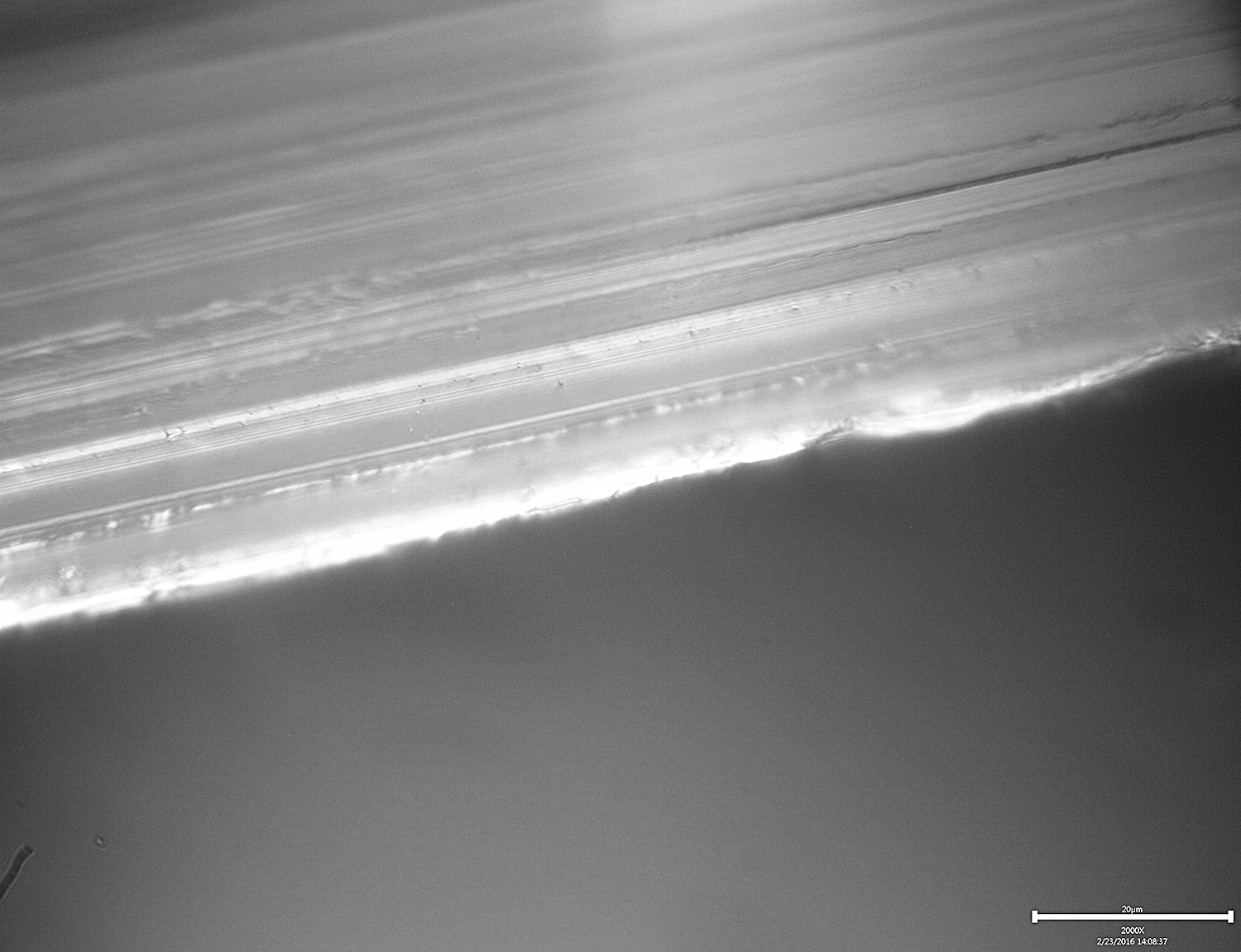

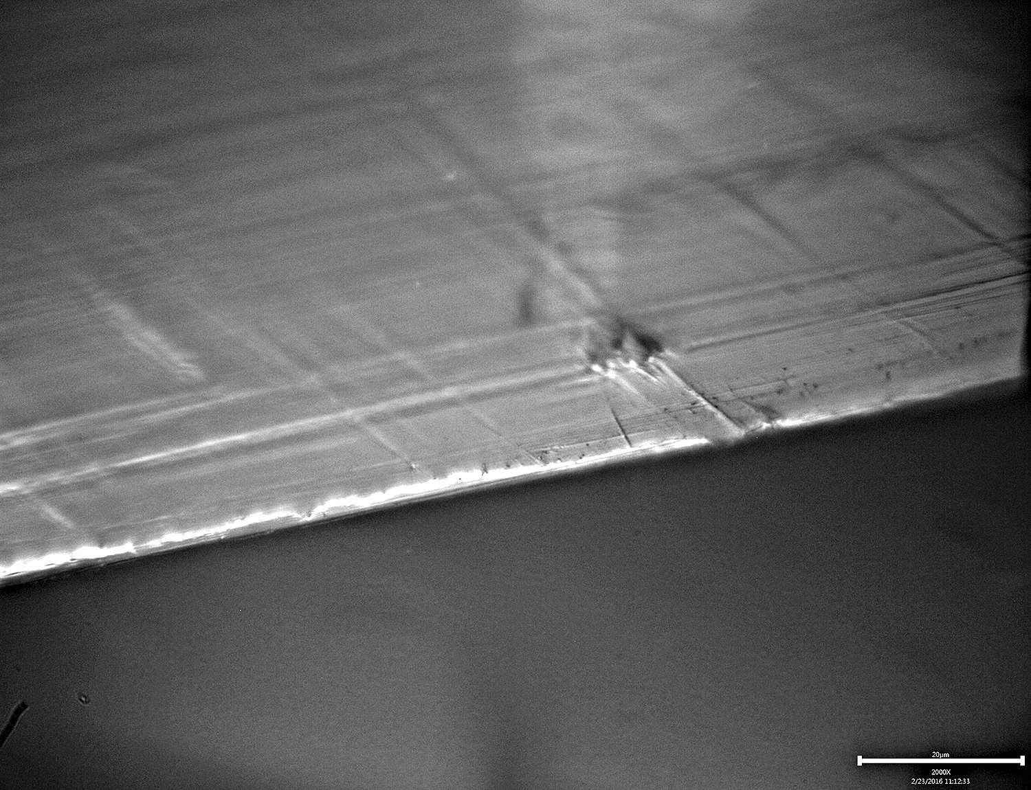

I redid the blade again. Here it is with a little micro-bevel and sharpening not quite perpendicular to the edge:
The edge looks pretty clean to me and it was super sharp. Here it is after doing parallel strokes, immediately after:
Here are some shots at 200x as well to get a little more context:
This last one is most interesting to me because you can see that there is some thickening happening to the edge.
Here is more of the thickening seen at 2000x:
I forgot to mention that the edge-parallel strokes were done with 1.5µ and 1.0µ lapping film. Pretty gentle stuff. I do wonder if the slight give of the lapping film allows it to roll over the edge and actually push into the very edge from the “top”.

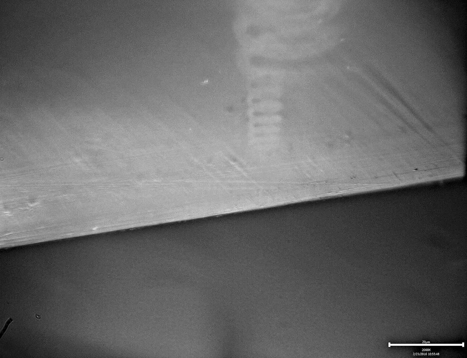

I decided to image the edge when stroked parallel to the edge with a coarser grit. I chose 400# and then I took three images with different focal lengths to try and get a composite with more depth of field. I stacked the images in Photoshop to create the composite:
[attachment file=“2000x-400#-Stacked.jpg”]
Here is one of the three images on its own:
[attachment file=“2000x-400#-2.jpg”]
That is very interesting Clay. You think the thickening is from some sort of micro-roll over? I could totally “see” that happening since the film is traveling along the entire length instead of rapidly being pulled over and off the edge in more traditional method.

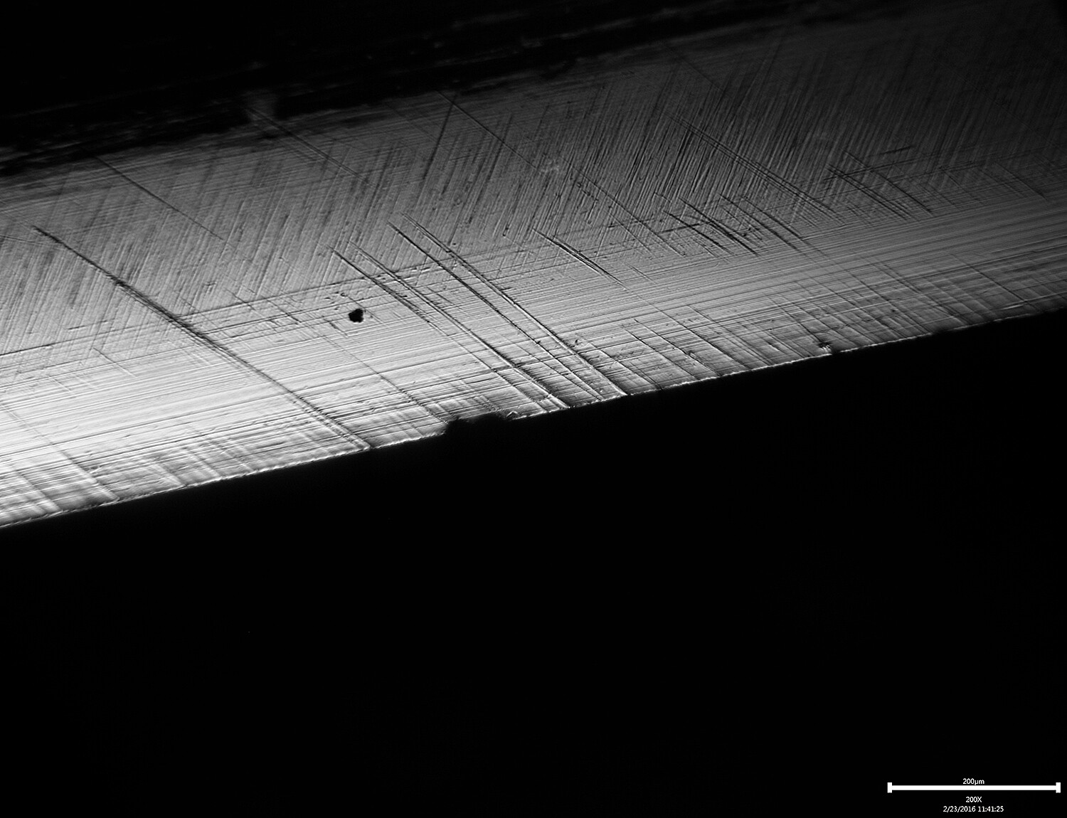

I couldn’t resist checking out 800#:
[attachment file=“2000x-800#-1.jpg”]
