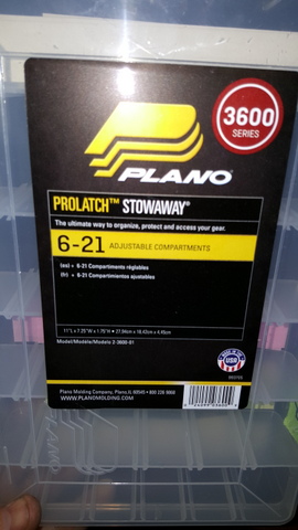

Recently on a solo mission to Wally World I found this small Plano tackle box for $6 while lingering in the knife isle. They had a similar box for $4 each, but the latches where inferior so I splurged. :slight_smile:
I could tell just by looking that it would fit lapping film strips perfect(and possibly strops?). While I was there I got the cheapo paper slicer for $9 as well. Then today made a quick trip by the auto body refinishing shop, came home and started chopping!
This box will house p1500, p2000, p2500, & 3000 grit paper strips, maybe a couple more later. I also have a second box laid out with 12u, 9u, 6u, 3u, 1u, & .3u lapping films.
As it turns out the box also perfectly fit 3 pairs of strops in their own separate contaminate free cubicles so I will be getting one more for those as well. There’s something very satisfying about the idea of having identical & inexpensive yet solid cases to cleanly store separately the final stages of the progression so I definitely wanted to share and for the newcomers that may be on a budget such as myself.
