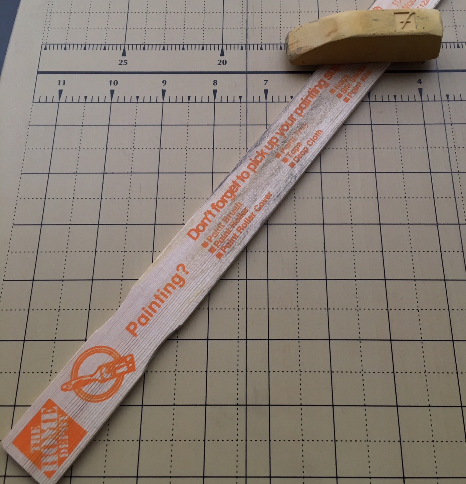

Yup… latest strop…
… paint stick w/ “FlexCut Gold”. Works great! :slight_smile:
I’m pretty sure the ones I get from the paint supply houses are Beech. Balsa is more porous, lighter.
