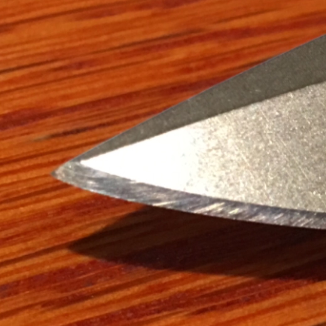

Hi everyone,
I’m really struggling here and i’m not sure why (other than I don’t know what i’m doing!). I’ve spent about 3 hours today trying to sharpen my benchmade impel. I’m not even aiming for hair whittling sharp, just being able to cut printer paper easily is my goal. After installing the knife in the WE and testing with a sharpie 19 degrees/38 degrees inclusive got me closest to the stock angle and seemed like the best place to start.
Starting with the 800 grit stone (first time sharpening since factory new) I was able to remove the marker at the top of the bevel on both sides without too much trouble, I then made sure a burr was being created on both sides to ensure I went far enough. I then progressed to 1000, then to the 1200/1600 ceramic stones, and finally strop with 3.5mu paste.
I’m not even sure if all those steps are even necessary just to cut paper well? Either way it didn’t work, at least not entirely. The middle of the blade and back to the heel are extremely sharp, mission accomplished. However the front quarter of the blade is much duller, unable to easily cut printer paper. I’m positive a burr was created across the entire blade.
Do I need to move to a more acute angle? Is there something else i’m missing? Thank you for any help!

Could be wrong, but just from your pictures, it doesn’t look like you’re hitting all the way to the edge…
… it looks like there’s a change in the grind at the very edge, especially as you near the tip. It could be, that, even though you created a burr with the first stone, the subsequent stones weren’t hitting the bevel at the same angle. You might try remarking your blade with a Sharpie between stones, and make sure each level is making contact in the same spot.
