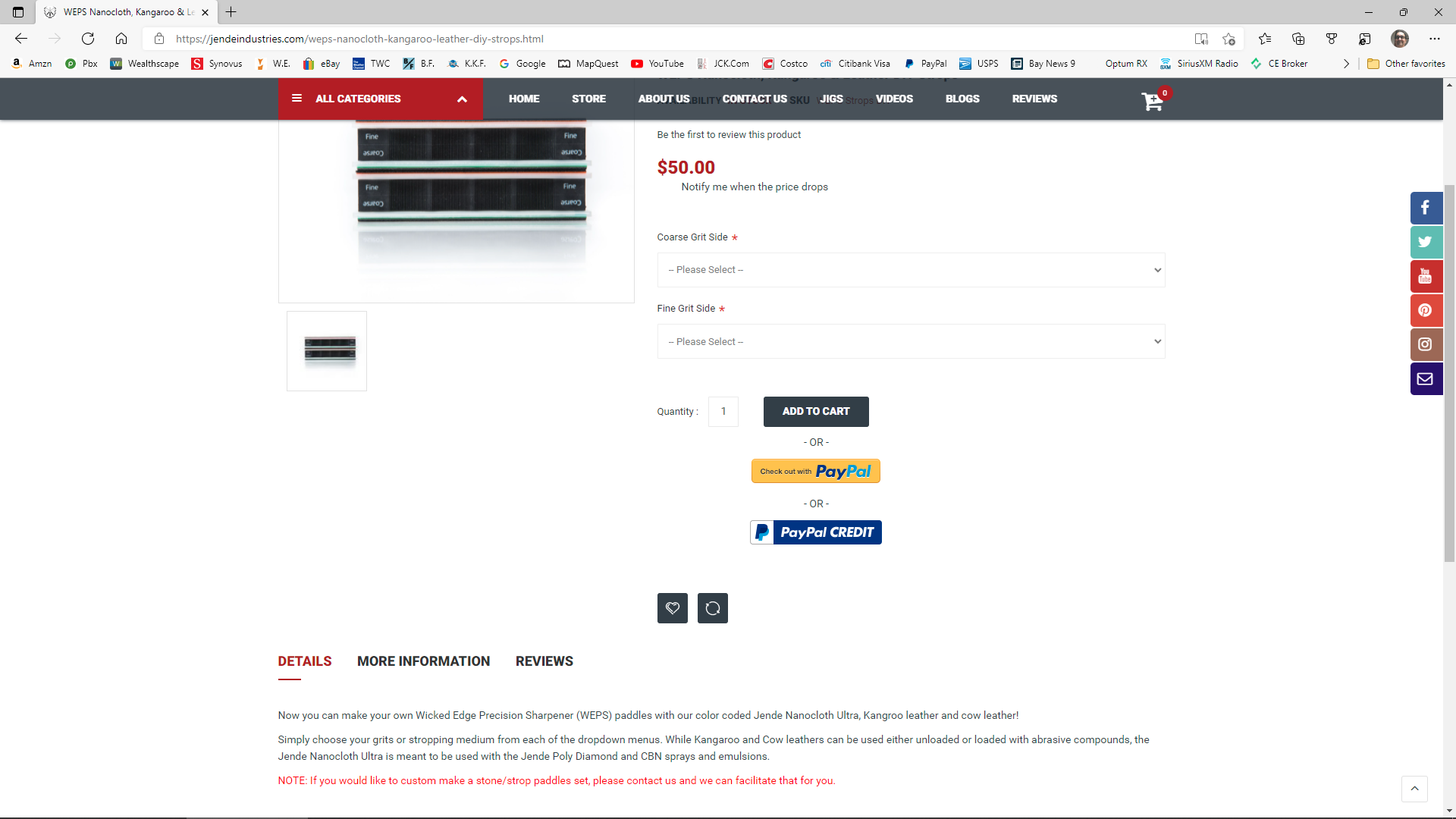

Hey anyone, quick question. I was looking at the jende nano cloth strops and am a bit confused on the the coarse and fine aspects in the options. I looked at the store on the W.E. shop and nanocloth is listed as nanocloth with no micron size associated with it. On the jende site the cloth is listed with multiple micron count options. I’m not sure if the micron options are for a spray or emulsion or the actual cloth itself. If anyone knows and can share some thoughts or input I’d sure appreciate it. Thank you so much.

See the last line above the red “NOTE” at the very bottom: While Kangaroo and Cow leathers can be used either unloaded or loaded with abrasive compounds, the Jende Nanocloth Ultra is meant to be used with the Jende Poly Diamond and CBN sprays and emulsions.
The Jende Nanocloth paddles for Wicked Edge are simply color-coded nano pads to match the label colors corresponding to the Jende product’s grit size you will apply on that pad. Whereas, with the W.E. paddles it’s up to you to label the nano cloth strop accordingly and keep them straight.
Marc, thank you. I really appreciate the time you took for a response. That clears it up.
