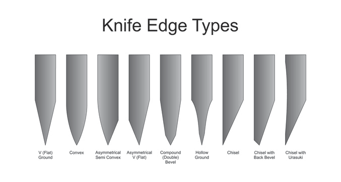

Do you mean type of edge like one of these?
Thank you for the diagram. I have VG-10 and ZDP-189 blades, wondering what the benefits are of the above diagram or some kind of direction on the “best” all around grind.

This page Knife Edge Grinds and Uses say that “V (flat) ground” is the " best all around".
I am not sure if you are asking about edge or about grind. Grind is “shape of the cross-section of the blade” as described in Wiki here. Edge is tip of the knife about 1/16" width. Grind is usually entire knife cross-section across from spine to edge tip.

ZDP-189 should be able to hold a good edge with as low as a 15dps angle easily. You may want to determine the current angle and still with that though as ZDP-189 is a hard steel that will take time to reprofile. VG 10 is used with a 15dps angle by many chefs. You are using it for heavier task though and may want a greater angle to increase edge strength and reduce the chance of chipping. A double bevel can give some of the advantages of greater and lesser angles to an edge in some people’s opinion and definitely makes touch up easier once the initial angles are established.
