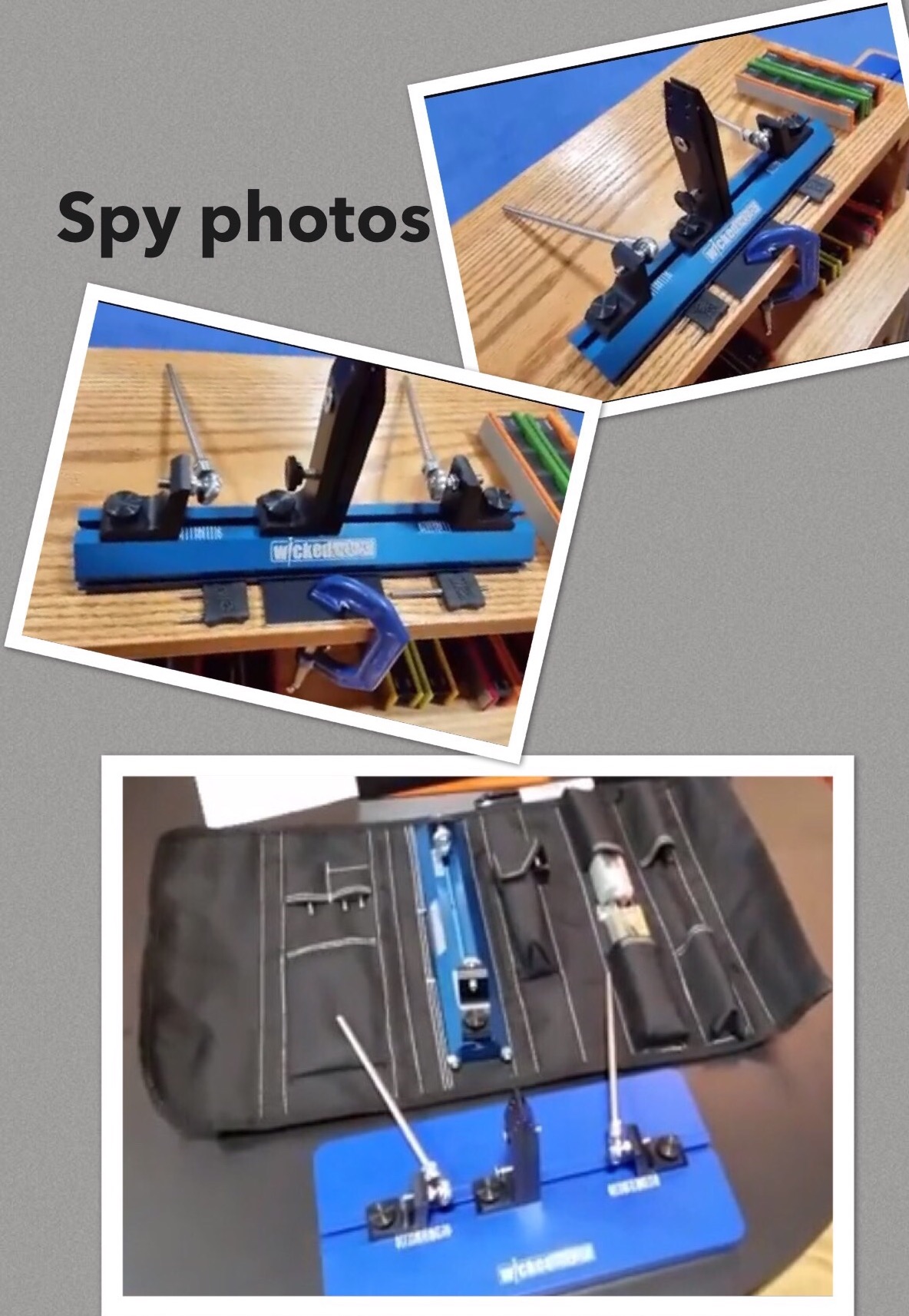

Apparently so…
Thanks guys and LOL, Curtis. Of course I’m curious where those photographs come from and what they actually show.

https://www.facebook.com/clay.allison1/posts/10211802932808194
(click on the date link)
Wow, very nice product! Is this supposed to become an alternative to the Field and Sport?
I don’t know… I just ran across the video. Haven’t seen it in person… but like the looks of it. (Like the 200/600 stone combo too).
I can definitely see the appeal of this version; it would be very portable so it would make it easier to bring with you every day. I could see myself wanting one of these so that I could bring a wicked edge to my parent’s house. As nice as the gen 3 pro is with its sturdy carrying case, it would be rather cumbersome to take it on a flight in addition to the other luggage I would need when I travel back to visit.
Wow! I just watched the video and Clay said that it would be retailing for $199! That makes it an exceptional value and puts Wicked Edge back in the discussion for those who are more budget conscious. That’s directly in the price range of the Edge Pro Apex and the KME.
Ah, the dangers of taking prototypes to shows. We’re hoping for a late summer release of these. The idea is to have a portable, affordable unit. I’ve really been enjoying these. One feature that’s not shown in the prototype is that the stones will actually store inside the base piece. The guide rods also store in slots in the base piece and the jaws lie flat when you use the thumbscrew to take them off of the base so the whole things becomes pretty compact. The basic case won’t have additional stone storage but a deluxe case will be available that has spots for two more sets of stones so you could travel with three sets total.
ps - we’re trying to keep this product relatively hush hush until we’re ready to release it. We showed it to dealers at Shot Show and IWA but don’t want to fully let the cat out of the bag yet. :wink:
