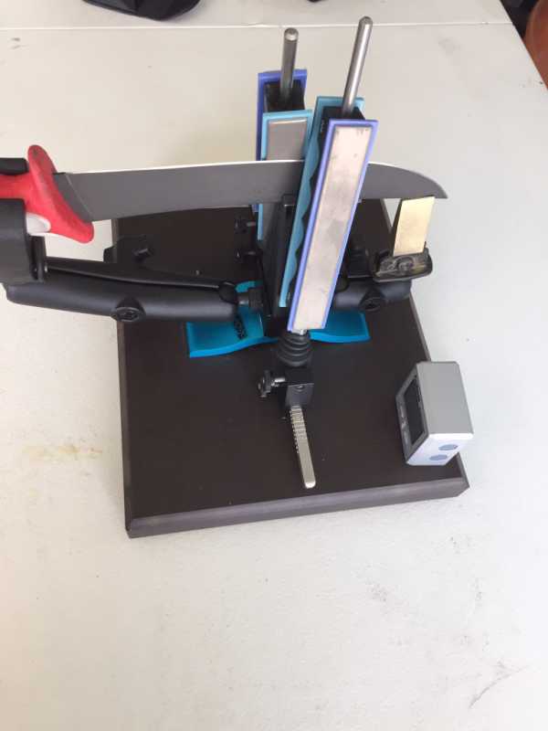

I had trouble using the rod included with the kit. The fillet knives would flex back and forth. I ended up getting a tormek adapter for small bladed pocket knives. I tried it with a fillet knife to get it up higher to do a shallow angle. Well the blade still wobbled but I then used a triangle file and cut a small groove in the end and BINGO. The blade fit into it nicely and no wobble.

It sounds like a good idea, but I’m having a hard time interpreting the pictures. Perhaps you could post some clearer pictures/pictures from other angles?

I guess he made a groove on tip of the bracket. Knife is positioned in a way that blade is inserted into the groove. Groove prevents the wobbling.

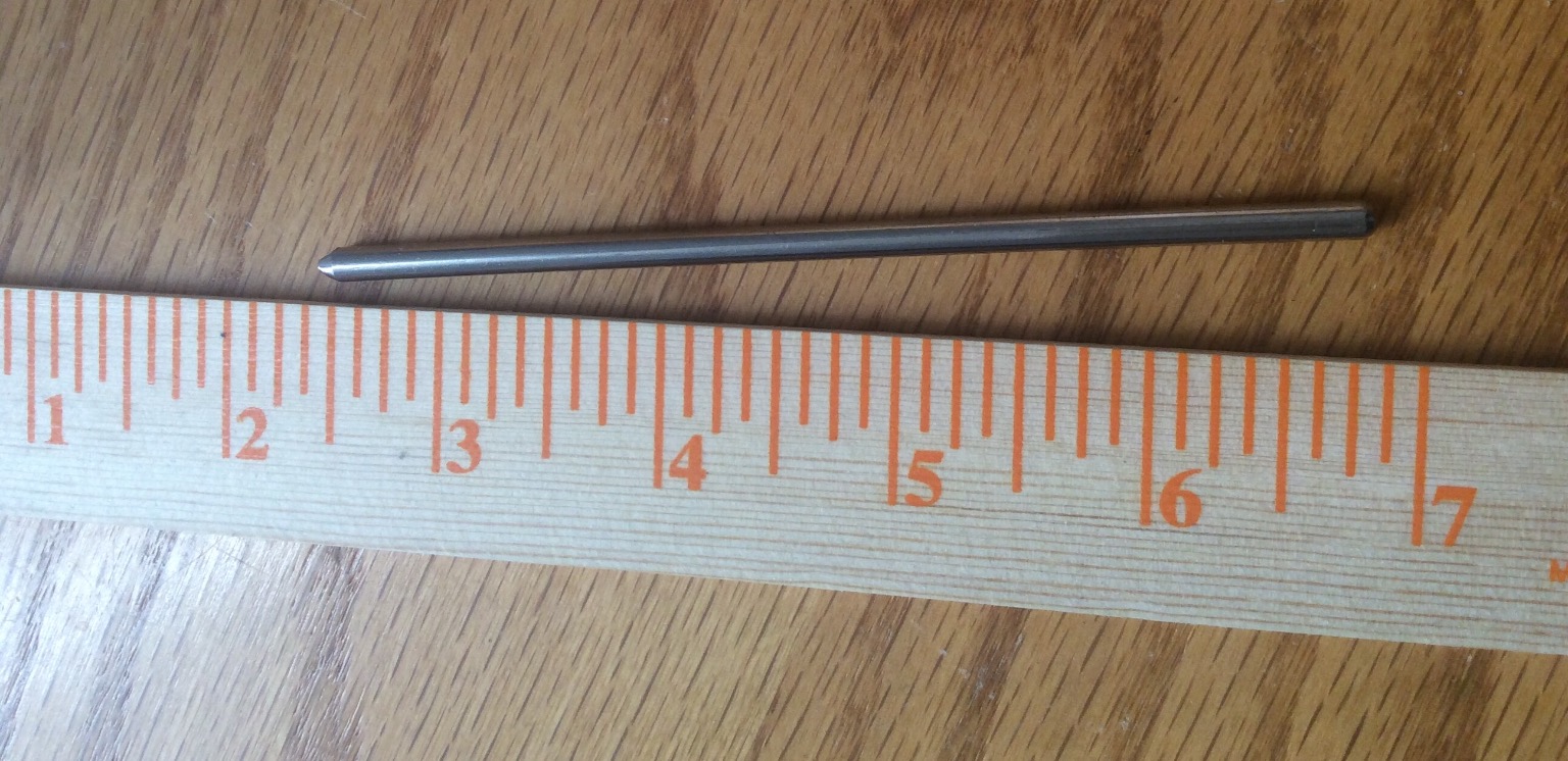

The brace with the original kit was a thin rod that fit in the small hole in front of the blue base…
… doesn’t work with the Field and Sport or any other model that I know of, and doesn’t work with things like the Low Angle Adapter. The idea is to brace a thin blade. (Put the ruler in just give a size idea).
Oh yeah, there was a tiny slot at the top to help try and hold the knife.
@cbwx34: Thank you for posting the brace picture. I am still not sure how it works.

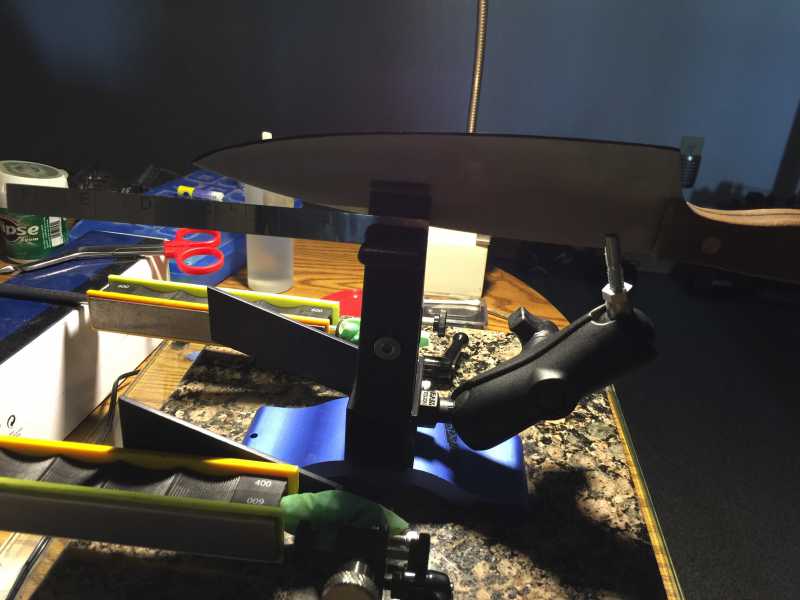

Your idea is not crazy… a lot of guys have done it. There’s pictures scattered thru the forum… although I can’t seem to find any. Some threaded a bracket into the base that would hold the handle. It’s a good way to do it.

Found one by pinkfloyd… he says it’s a RAM arm…
