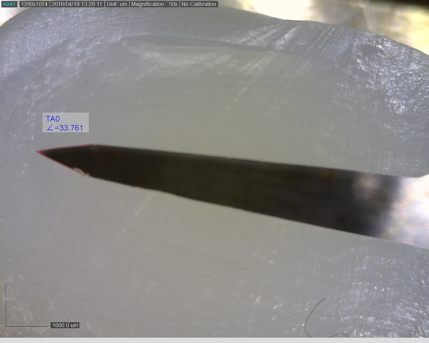

Well, I just received Polymorph that I ordered from http://www.polymorphplastic.co.uk/ and did a quick test by just pushing a small bubblegum size amount on the edge and let it harden. I am very pleased with the results.
[attachment file=“A085 - 20160419_155637.jpg”]
[attachment file=“Polymorph 1.jpg”]
Frans
That looks great Frans! My batch of ThermoMorph came in yesterday and I’m hoping to try it out today.
Great, I am looking forward to your results.
WOW! Outstanding result! Have you done any measuments with your scope? I am presently in the Middle East it’s going to take more time to get to me via the military post office. This really looks great! Do you have any other observations? Time to cool? Ease of use? Reusability? Tell me more please please!
Yes, just a quick measurement.
[attachment file=“Polymorph met meting.jpg”]
It is very easy and clean to work with. It does not stick to the blade at all. It cools quickly and I did not feel the need to cool it in icewater or the fridge. Once hardened, it is very easy to cut / shave and it will hold its shape. I have not yet tried to re-melt it but I have no reason to believe that would be difficult or give other results. You just need a small amount so even without re-melting you can do a lot of knives with 250 grams. The bubble gum sized piece in my previous post weights 1.54 grams.

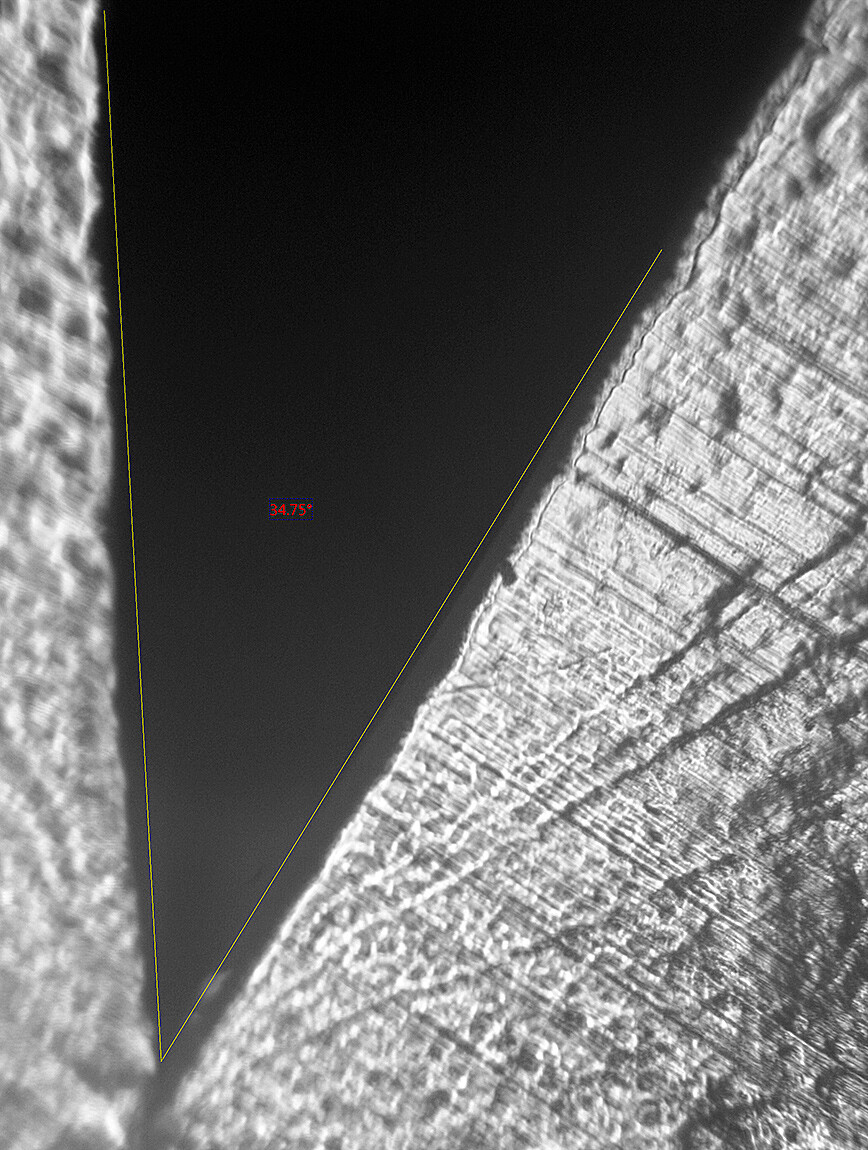

I had a go as well. My images aren’t nearly as pretty! Still it was pretty easy to do and I’m sure I can take more care to get better cuts and images. The magnification on the scope I was using is too high, so I’ll probably switch to the Dino-Lite in the 20x-50x range so I can see and measure the transition from bevel to micro-bevel more easily. Here is 80x:
[attachment file=“ZT0770—4-19-2016—A.jpg”]
And here is 200x:
Outstanding! Even more excited now. Bye, Bye expensive goniometer that is hard to read. No more guessing the angles. WIN WIN! Are you seeing it guys? The Magic that has been revealed? You can see if the edge is centered on the blade. You can measure the whole edge triangle. No calipers needed or trigonometry to figure out the angles. I have a whole lot more. Think of the time savings? Before you even put stone to blade look at all the information you get. Not to mention multiple facit blades like making a convex. Think of the library of possibilities! We have been looking at drawings or PowerPoint slides of edge profiles, now, we can see our own, share them, and reproduce them.
I went ahead and took it to one of the Dino-Lite scopes set to 50x:
We can also perform blade life calculations based on the amount of metal removed. We can profile the whole blade geometry not just the bevel geometry. For those of us providing sharpening services, we can truly provide “precision” services because we can now measure it and save the images in customer blade databases. We can provide before and after shots of the work we do to justify and quantify the work we do. A picture is worth a thousand words. Us sharpeners have always had esoteric ways of explaining knife geometry. Now with this tool we can prove it and better yet document it. The “sharpy” is a great tool too, however, it"s gone as soon as you start scrubbing the blade. In the medieval times they used soot from burning candles to ensure perfect blade angles. We are in the age of the computer, we can leverage it’s power to bring credibility to the art of producing the best edge! Off my soap box now, but seriously, think about it!
