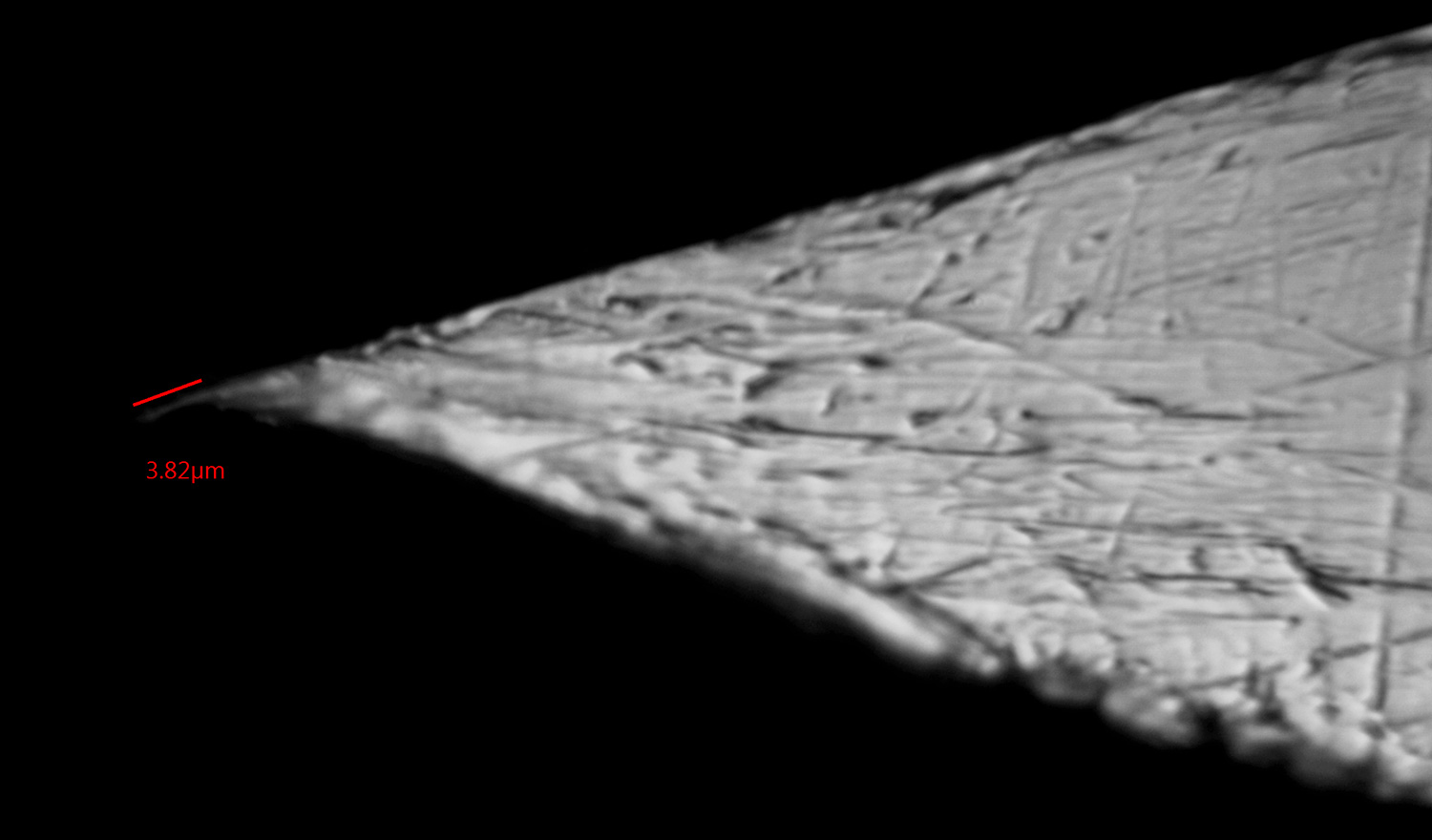

Edge trailing definitely can pull up a wire edge, even when you’re alternating every stroke. I wanted to try and reproduce some of Todd’s SEM work with my scope if I could and I also wanted to dig in a little further into the issue that I documented when the edge collapsed under light pressure from the microscope, so I cut one of my sample blades to reveal a cross section and then sharpened and stropped it. After about 40 strokes with the strops, I had a very definite wire edge drawn up:
You can see a definite wire edge extending from the apex. It’s pretty small, only 3.82µ in length and 0.62µ thick. The photo was taken at 2000x.
Can edge-leading strokes do the same? Of course it would have to be tested at lower grits or with film.
