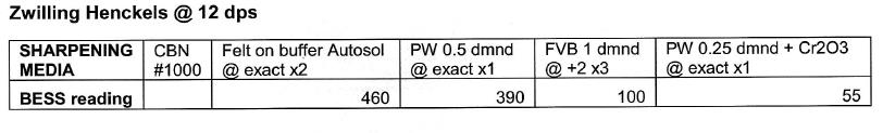

2 - My apologies. I was basing some of my answers on Kraichuk’s book " Knife Deburring - Science Behind the Lasting Razor Edge By Vadim Kraichuk". In it he gives several example of how to sharpen various knife steels using Tormek sharpening equipment. With softer steels he often uses a paper wheel with Autosol, a 0.3 micron grit, on the wheel. For example:

4 - It is, but that last step is intended to only further clean the apex of any damaged/stressed/weakened steel. My experience is that this last step makes a noticeable difference in the sharpness of the edge.
