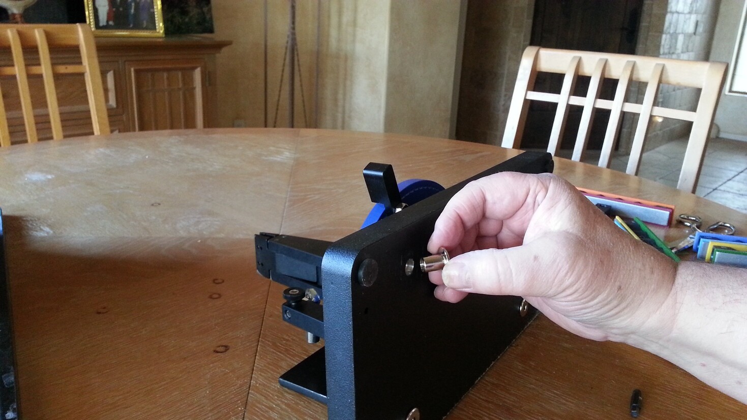

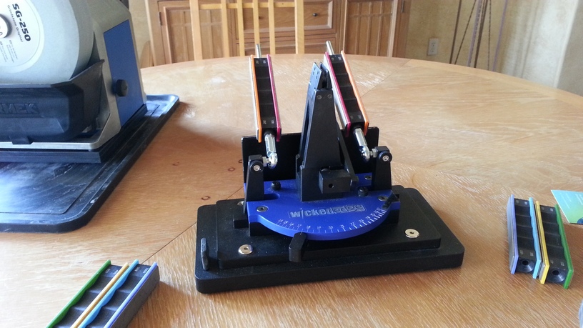

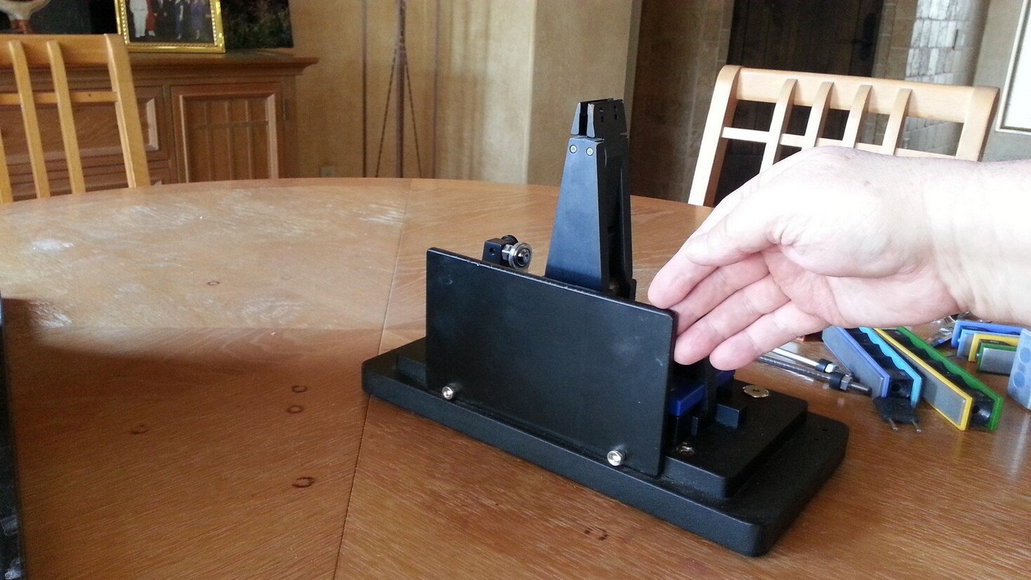

Mark,
Give me a little time and I’ll detail more clearly how I attached the two plates together. You’ll have to make a trip to the hardware store, as you cannot do it with the supplied WE hardware. I think I spent less than $10 to for the hardware. Stay tuned for a few more photos.
Okay guys, first off, you will need to make another back plate, as the plastic WE plate will no longer fit. I guess you could trim down the WE plastic if you wanted to. Here’s a plate I made of aluminum for mine.
Once you remove the WE he bolts, you will find that the threads for these bolts are in the side panels that hold the two horizontal plates. The two plates have threadless holes, four each per plate. At the hardware store, find the type of bolts as in photos, sorry I don’t know what you call them.
(photo limit reached, continued next post)
here’s the other photos
PS - Mark, I removed the bolts on the bottom plate just the same as you did from the top plate.
Note that my WE Gen 3 Pro is over a year old, so yours might be just a bit different, as mine had steel hex bolts, same as the top plate did.
