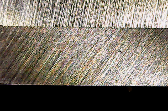

Finally was able to revisit the Spyderco Manix 2 S110V blade. After receiving the 800/1000 chosera stones, I tried to back up and see what they would do ( I finished with the 10K chosera last go round) while keeping the same 18 deg angle. I was not successful.[attachment file=“800k.bf2.jpg”]
From there, I went back to the 1500 diamond confirming the scratches were consistent from shoulder to apex and verifying a burr before moving on.
From here, my progression was 800/1000/2000/3000/5000/10,000 chosera. Scrubbing first then edge leading, per forum recommendation, with very light pressure until each grit had scratch uniformity. Finally, light stropping at 16 deg with both 1 micron and 0.5 micron leather strops.
Again, this blade is sharp but not where near where I would expect it to be. I do not believe it is my technique as I followed this with a Shun VG10 blade using both diamond and chosera to 10k and it is screaming sharp! I know the S110V steel is supposed to be difficult to sharpen but I am at a loss… I have ordered a set of DLF from 6 to 0.1 micron and will try them when they arrive. I can’t imagine that the DLF will solve my issue but don’t know what else to try.
Rich, just a dumb question first…Please clarify how your photos are oriented so I’m clear on what I’m looking at. Are they posted “bevel down?” If that’s the case, for less confusion you may be able to change a setting in your soft to rotated the view 180º so the bevel is up to coincide with knife clamped orientation.
To help your issue, I suggest, just for kicks, repeat your Chosera’s 5K then 10K. Feel the apex when doing the alternating side, bilateral, edge leading strokes to make sure your edge feels very sharp.
First, what type of strop are you using? I assume you’re using the basic cow leather WE strops. But we both know what assume means, LOL.
Try to lower your angle for Stropping, , per side to 15º and then do your alternating, bilateral, edge trailing strops. Please let us know the results. If this doesn’t help you might also try to lower the strop angle only to 17°, after again going back to the 5K and 10K Chosera’s. These little technique changes may help you narrow down your technique issue.
From viewing the photos your bevels look pristine. Like they were done by a machine, they’re so straight and even and parallel. Really good work there.
I think you may be battling the Niobium carbides in the S110V vs the Vanadium in VG10. Niobium carbides are much harder. The chosera stones may not be hard enough and you could be just abrading the steel matrix “around” the carbide and messing up your apex. You prob can only see it with an electron scope (on my list - LOL).
Try not using the chosera at all and see how far the diamonds will take it. Maybe use diamond emulsions on cardboard at the finest level. Zknives.com and knifeinformer.com have great info on S110V basically calling it THE HARDEST to sharpen and sometimes heat treated to 64 RC.
The photos are taken apex down. Marc, I will try your suggestion of repeating the chosera 5/10k. I believe the edge felt very sharp when finishing with them. I will experiment with strops at 15 deg and 17 deg. The strops I am using are cow leather (not WEPS as I just replaced them with leather form Oldawan) Yes, ASSUME (ASS out of U and ME). Thank you for the kind words, I am really paying attention to the details!!
Readheads, your suggestion is were I was headed. I am skeptical of the chosera stones use on S110V. I have ordered diamond lapping films and will try when they arrive (after trying Marc’s suggestions above). Talk to me about diamond emulsions on cardboard. This is just another form of stropping? Why cardboard and not a traditional strop media?
This leads me to another question. When talking sprays & emulsions, what are the differences between CBN spray/emulsion, poly diamond emulsion, boron carbide emulsion, etc. Is one better than another or just different? Reasons for using one over another?
Lastly, has anyone used chosera stones with S110V, CPM S90V, ZDP-189, ? If so, what was your experience? I really enjoy the feel these stones provide during the sharpening process. I am trying to understand if there are applications where they should not be used.

Rich, how many different steels or different knives have you sharpened so far with this same Wicked Edge System? Have you been able to sharpen those knives to a sharpness of your liking?
Yes I have. Many various kitchen knives, ZT folders, Kershaw folders and spyderco folders. No others using S110V though.
Did you sharpen these knives with you’re current setup to a sharpness of your liking?
Yes I did. All of the other knives I have sharpened turned out great!
I had a conversation with Ken Schwartz today. His opinion is that the vanadium content being so high, the chosera stones are not able to erode these steel nuggets. His recommendation was two fold,
  1. Add a small amount of cbn (WATER BASED ONLY) of the same micron size to the chosera stone surface. This will help to produce more slurry by eroding the chosera more rapidly while adding diamond particles to the slurry taking care of the vanadium in the steel.
  2. Nubatama Platinum stones. It was explained that these stones will take care of these harder steels where the chosera fall short. I'm considering 1500/3000 to start, then strop from there with cbn/poly diamond emulsion.
Also, I have DLF on their way. I know these will take care of the issue but it's good to have options...

I wanted to follow up on my progress with this knife. I received diamond lapping films from Nanolap, 6/3/1/0.5/0.1 micron. These did the trick! Much sharper thank before!! I did have the same issues with the 0.5/0.1 micron films with larger scratches showing up. I will proceed with the DLF to 1 micron, stop there and move to strops!
I really enjoy the chosera stones and will continue to use them where applicable.
Thanks for all of the input!
