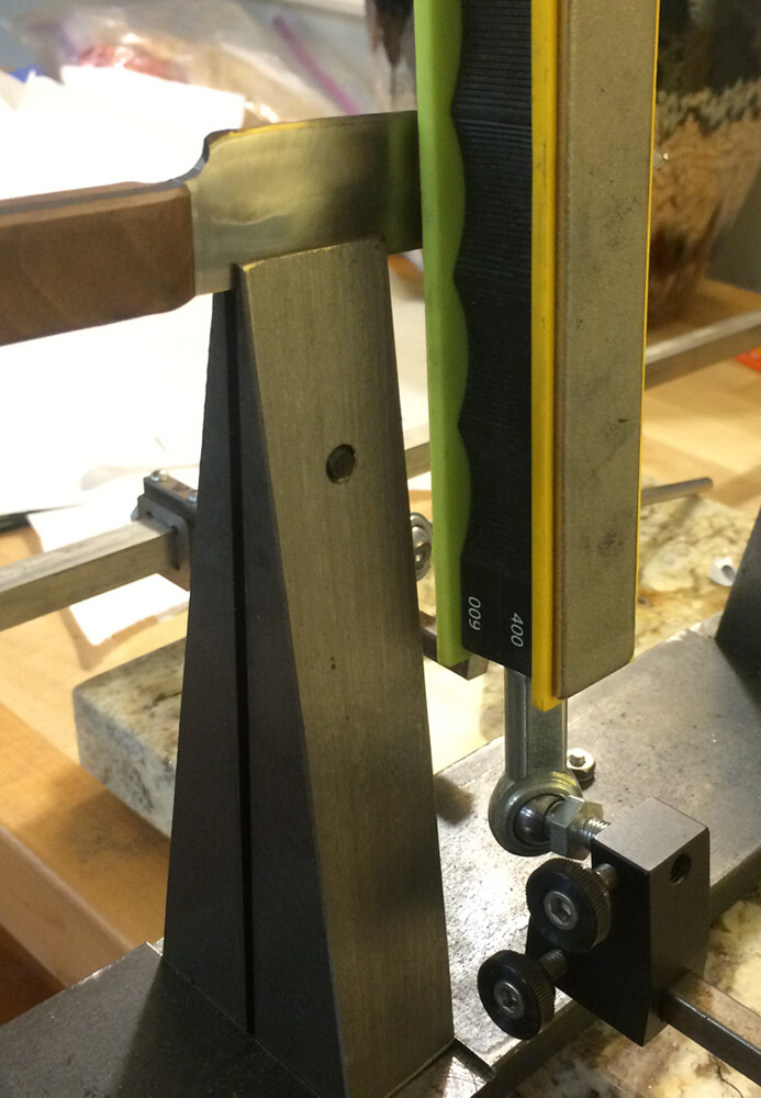

It’s getting there. The attached photo shows the rails on the bottom of the cross pieces. I think I will put them on the top instead as the square piece that holds the arm will be too low in this configuration. More to come as I finish it. I used 10 1/2 inch stainless slide arms. Is that what you guys use?
[attachment file=“Wicked Edge 2 Vise.JPG”]
Each time I found myself with a knife mounted higher and higher, I’d make a longer pair of rods. Right now I’m at 14" and really, the added length isn’t a significant concern. It’s just a little farther I have to reach to slide on the next stone blocks. How’d I end up at 14"? I had a very small blade with a very low bevel angle. When I mounted it in my Tormek Small Knife Adapter and mounted that in my Low Angle Adapter, I was up in the clouds. To boot, my home-made blocks have bronze bushings with an over-sized bore. This means that if I reach the end of the rod, it slips out of the bushing and the angle changes slightly. If not for that, I could be at 12" and be happy.
BTW Bill, I think I see in your photo that you have the square angle bar attached to the movable jaw of the left (as seen in the photo) vise. Isn’t that going to be a problem if you jack the movable jaw to accommodate an FFG blade?? The easy fix might be to reverse the vise on the left.
At one point, it occurred to me that the WE vise was configured so that you didn’t use the top inch or so of the stones, except on wider blades. To regain the inch, I cut off part of the rod-end coupling, reducing the amount of thread engagement to only about three turns. Since there is no longitudinal force to speak of, this isn’t a problem. Of course, I cut off the unused threads from the rod as well. End result, longer strokes on narrow blades. Longer strokes mean longer life. No innuendo intended.
tcmeyer Is the area circled in red the place you are talking about? If so, the square rod is not attached to the vise. The end of the rod is about 1/2 inch away from the vise.
The swivel ball I got only gives me a maximum angle of 32 degrees. I am an novice when it comes to blades but I guess that will do for most blades I sharpen. Another down side is it does not have the hex socket in the end. Does anyone know where to get the ball sockets used in the WE?
[attachment file=“Wicked Edge 2 Vise tmp.jpg”]
The nice thing about this design is that I no longer need the low angle adapter. I can slide the bar over so it is between the vises and get a pretty low angle.
I don’t think I’m understanding how you’re using the two vises, or how moving the degree bar results in a lower angle. If you view the vise/rod from the end, the angle is constant, regardless of the relationship between the relative Y positions of the rod end and the blade, assuming that the blade edge is a straight horizontal line.
By placing the assembly between the vises you can move it closer to the blade which gives you a smaller angle. This only works if the whole blade is off set from the vise. If the blade is clamped in the vise, you would need the low angle attachment. On my new Mod I made the bar longer so it is closer to the vise so I can get a smaller angle.

The two vises allow you to clamp longer blades with greater stability than can be achieved with a single vise. The new mod will clamp about a 16 inch blade. The original one will clamp a blade about 24 inches long, in reality longer than anything I will ever sharpen. When I came up with the design, it wasn’t much trouble adding a third vise, so I did.
I finished the WE Mod. I am pleased with how it turned out. I will probably clamp it to the table with a C clamp as opposed to using some type of base. It turns out I can sharpen an 18 inch blade without having to move it in the clamps.
